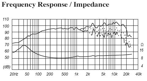

And speaker impedance isn't actually at their 4/8/16 ohm? That was true.
For example : fostex fe206 resonance at 40Hz because weight and spring.
Yep, speakers are generally rated at a 'nominal' impedance. This is usually quite a bit above their DC resistance or the minimum they may achieve across their bandwidth. At the low end, you have the resonant characteristic of the driver given by the Thiele/Small parameters (which are actually derived from the impedance using an equivalent circuit for the mechanical system, but anyway...). On the high end you have a lossy inductance, but finding a manufacturer that specs anything other than Le @ 1KHz is uncommon (TC Sounds is the only mfg I know that actually specifies Ls, Lp and Rp for the better inductance model). Once you start throwing in another driver and a crossover things can really get wacky if you are not careful with the design. Bad designers can screw up and easily give you load impedances well below nominal impedance and/or impedance with phase angles more than 45 degrees capacitive. Either is not well liked by solid state amps, and I think can have much more detrimental effect on the sound than something like damping factor. But that's probably more than most wanted to know about that....
