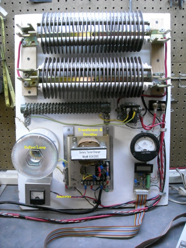

I have a home-brew computer-controlled battery tester that uses 1200W locomotive braking resistors as the load. This is for 14V aircraft and automotive starting batteries, where the load current is initially ~35A (440W). Since these resistors have a relatively constant resistance even when hot, the current drops off a little as the battery discharges from 12.6V to 11.0V, but it is easy to calculate the Amp*hours delivered as a function of the battery voltage because the resistance remains constant. For this reason, I would not use a lamp, whose resistance varies widely as a function of filament temperature.
btw-my computer-controlled tester logs the discharge curve, time to discharged, Ah, capacity, terminates the test when the cutoff voltage is reached, recharges the battery automatically.
