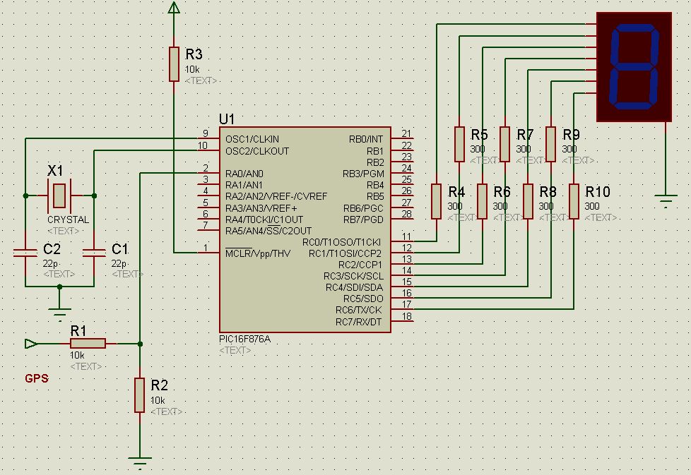

I re-created the Gear Position Indicator schematic (see attached) and it works great while on the bench. As soon as I put it on the bike it screwes up the signal coming from the Gear Position Switch to the ECU. It seems like voltage divider drops the voltage required by the ECU. Is there any way around it?
Is there a way to output certain voltage from PIC?
Here is my code:

Try to change the 10K resistor (R2) in the circuit you have attached for a 100NF capacitor.

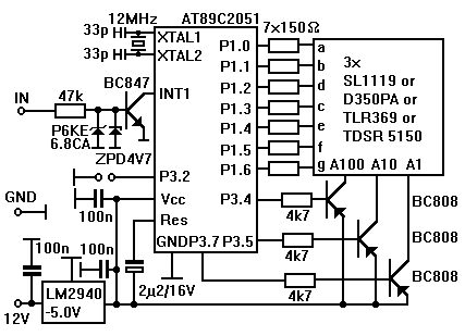

Hi people,
first of all, congratulations for this great forum,
second, sorry for my bad english....
I have a Suzuki gsxr 750 from 1996 that has the GPS sensor and i've found the correct wire.
Now i am trying to use tho code made by KIKO and GRAMO:

and i am using the same schematic of **broken link removed** (gramo)
I've tested in Proteus and it seems to work ok, but i cant makt it work in proteus with a external xtal of 20Mhz.
I am not using the LM LCD.... I am using a "POWERTIP pc1602F B" and the best tadasheet that i've found from it is **broken link removed**
Does this lcd work with "our" schematic?
I cant get the circuit working....
Can sameone give me a help?
Thanks.
