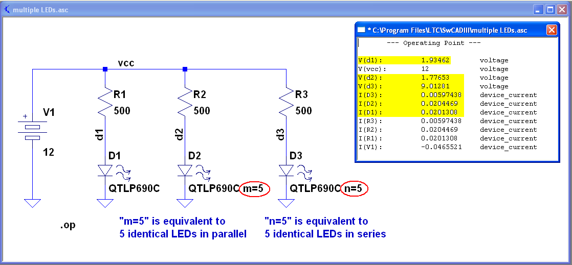

I was browsing through chips on the web and one of them included an .asc file that had a device (LED) and a notation that indicated that it was 5 LEDs, even though there was only one symbol. I have been trying to find the format for multiple devices, but have been unsuccessful. Can any one help me.

Here is an example of what I think you are referring to. To add the "m" or "n" (multiplier), right-click on the value of the part and type in "m=5" (or whatever number you want). Don't enclose it in quotation marks. A test shows that m works for resistors, but n doesn't. Go figure.
Thank you, exactly the information I was looking for.
Kinarfi
A double thanks Ron, didn't know that.:)
In the past, I had used fractional values of "m" to cause a Vbe mismatch between transistors. I learned about "n" by experimenting with the LED sim that I posted, and then discovered that it is documented in the diode section of LTspice help.
