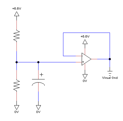

Split power suppy (+/- 3.3V or +/- 5) from +9-12V DC solution for under $6?

Yes it does seem overkill to power 8 opamps and would rather use linear regulators. I'm not sure how to model the usage model of the opamps as far as load imbalance but I don't think it would be greater than 20mA. This is for a video processing and driving application.
I looked into just DC biasing the opamps so I can only use one rail but believe it or not the part count for that solution doubles and the price of doing that is actually more than just building a dual rail solution since you have to use large caps in between opamp stages for video applications. Plus quality suffers (line droop) if you don't use proper clamping. Basically a single rail solution for video processing is messy IMHO.

The only solution posted here was the divided down 6.6V or an integrated smps IC since I already said I won't be using an AC wall adapter.

The virtual ground was a perfect solution using a DC wall wart adapter, and frankly your reasons for not using an AC wall wart adapter are flat out stupid. Every major electronics supplier offers them, and about 25% of the ones I've collected from old electronics are AC output and not DC. They are not hard to find, and they do not cost more. If you are making a product that needs + and - rails using an AC to AC adapter is just a no-brainer. Buy them in bulk and include with your product. Instead you are looking at SMPS stuff - do you even know about EMI compliance or what kind of a hassle you'll be getting into if you go that route?

I'll re-visit the AC wall adapter I suppose, and I agree it's a better solution for my application if AC wall adapters are both cost effective and easily replaceable. It's just for the most part nearly every single electronic device I have and know of uses DC wall supplys, even devices which I know for sure have opamps with +/- rails. I also know they use DC-DC smps. They may have bigger power requirements than me though.

Considering that the output is from an OpAmp, it is unlikely that the current between the "ground" and the power rails would exceed the capability of one OpAmp. Hence this solution:
