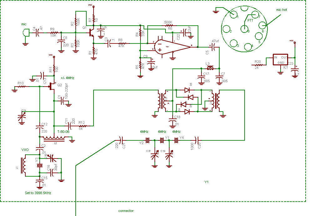

Anyway, here is the schematic of the modulator. I cut out the up converter since it is not quite done yet. The diodes are 1N914s. I measured the forward resistance on them and they are all the same. That is under minute light because the light will effect the resistance. The silicon in a glass case will produce electrons if struck by light.

I would recommend not running your op amp Vcc supply from your Q1 collector.

Circuit, Vcc, resistor.
There is only 10 oHms from the collector to Vcc and the noninverting input seems to be at quite stable point. It appears, the the designer of this part of the circuit did see it as some form of a negative feedback. Pretty unussual, but not harming.
The amplifier, made up of Q1 (Assuming beta = 200) and it's associated components, improves the input impedance of the OpAmp circuit from 47KΩ to slightly less than 43KΩ. It also adds much needed noise to the high performance 741. :rolleyes: I wonder how much residual FM this circuit produces, considering that there is no buffer between the oscillator and the mixer.

Well one big deficiency in your drawing is the output of your balanced mixer is wired directly to your crystal filter. A passive diode mixer must have it's output matched to a wide band 50 ohm load. This can be done with either passive or active circuits, but is a requirement for decent performance. A mini-circuits application notes for balanced mixer goes into this subject extensively. The input of your crystal filter is going to be a very complex impedeance and be very frequency dependent, anything but being a good wideband 50ohm match.

Well one big deficiency in your drawing is the output of your balanced mixer is wired directly to your crystal filter. A passive diode mixer must have it's output matched to a wide band 50 ohm load. This can be done with either passive or active circuits, but is a requirement for decent performance. A mini-circuits application notes for balanced mixer goes into this subject extensively. The input of your crystal filter is going to be a very complex value and be very frequency dependent, anything but being a good wideband 50ohm match.

Tell ya what Lefty. As I got more & more power I did hear a slight carrier. But I got two stages done on a 3 stage linear amp and put in some filtering along the way to where any crud from the up converter mixer is about all gone and as I come up even more the signal is about to destroy my receiver. If I zero beat I get feedback with max receiver attenuation. That being said, I cannot even pick up any carrier even with the receiver gain
turned up. It appears that noise from the mixer in the up conversion can slip through the filter initially and can be picked up as carrier. As the signal increases and is cleaned up it has disappeared. I have just finished two of the 3 stages and with no matching network ans the coax ungrounded, just feeding the center conductor through a capacitor to antenna, I am measuring 1 watt. If I give it a good whistle in the mic. That will be the final's driver stage. Unfortunately the final I have on hand is only 40 watts. An MRF477. Now I got an MRF320 rated at 80 watts but the range is up to 175 MHz. Would probably feedback if I try to use it. Any opinions before I put in this 40 watt? Would rather have 80 watts but might not be feasible.
I hope you have a LPF before your antenna.

But.....I will bear this in mind. I always look for results. It just turned out that it came out real good! Got lucky that time :). The last diode ring I made worked pretty dern good too. But the voice was a bit choppy like the diodes were'nt turning on exactly at the right time. So I got to admit, all of Nigel's bashing got through to me...lol. I did not realize the diodes had to be closely matched like that. So here it goes....
