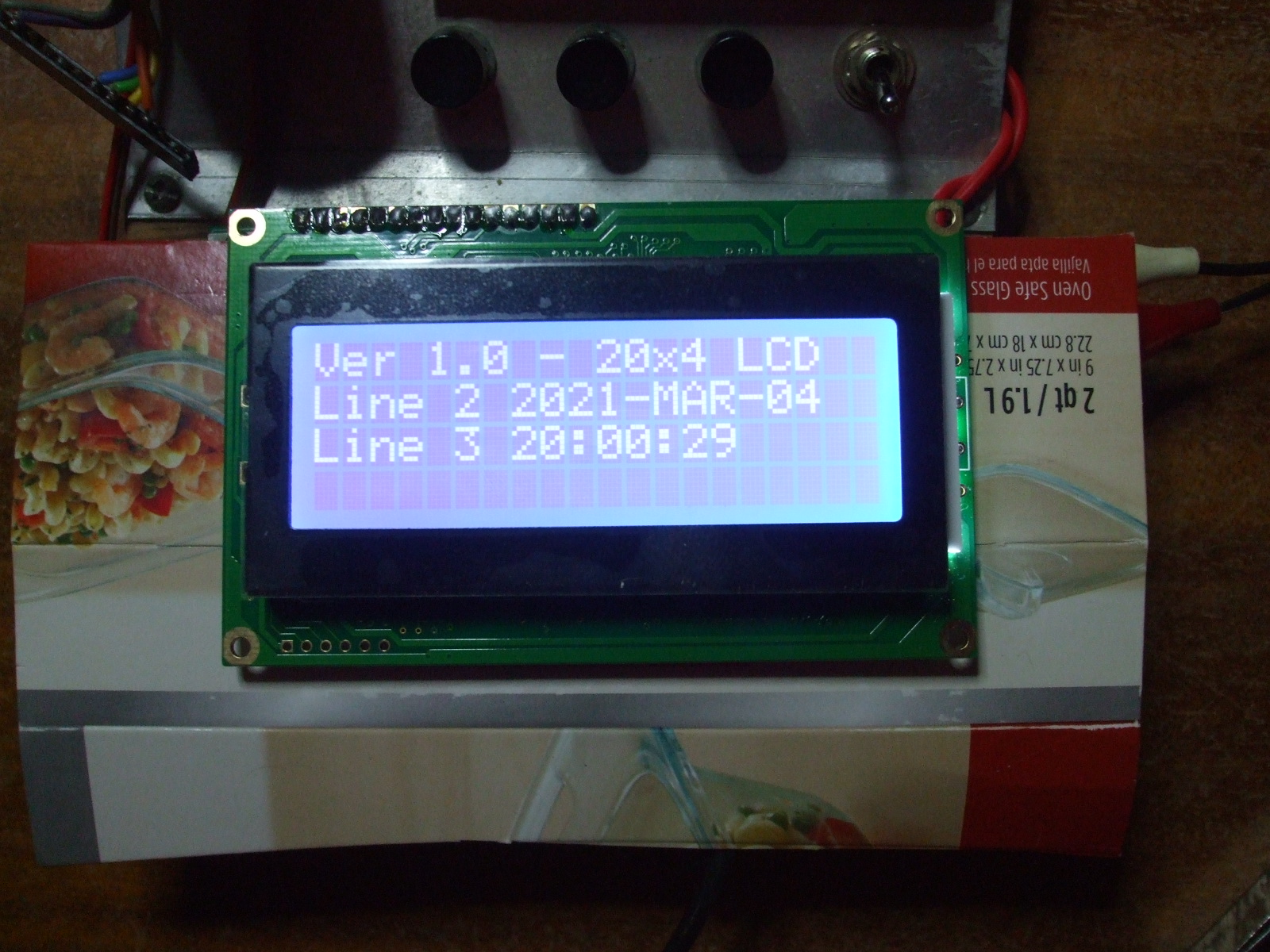

Maybe the 4x20 is slower and needs the busy check back in. I noticed a bug in your busy test code, you test the port after switching off the enable pin. You need to test the busy flag while the enable line is still high.
I.E.
busy_check
    banksel  TRISB               ; Switch to bank for Tris operation
    movlw    b'00001111'         ; Set ALL 4 to input, others outputs
    movwf    TRISB
    banksel  PORTB
    bcf      PORTB,LCD_rs        ; Set up LCD for Read Busy Flag (RS = 0)
    bsf      PORTB,LCD_rw        ; Set up LCD for Read (RW = 1)
    bsf      PORTB,LCD_e         ; Set E high
LCD_is_busy
    btfsc   PORTB,LCD_busy       ; Is Busy Flag (RB3) clear?
    goto    LCD_is_busy
    bcf     PORTB,LCD_e          ; Set E low
    banksel TRISB                ; Switch to bank 1 for Tristate operation
    clrf    TRISB                ; All pins (RB7..RB0) are back to outputs
    banksel PORTB                ; Switch to bank 0
    RETURN
Note, the 4 lower bits of portb all have to be input. Although you're only interested in B3 the other LCD pins will also be outputs (when you read) and will cause a conflict.
BTW, did you know the banksel macro sets both bank bits RP0 and RP1. It doesn't matter here but if you run out of code space, it's good to know.
That's one of the other things that wasn't working with the 20x4 and why it was commented out (but of course it works fine with the 16x2 LCD).
I'll dig in to that tomorrow if I don't get called out.
A lot of the new displays that are HD44780 compatible are much faster and are never busy so checking the busy flag is irrelevant but you never know which you have. I'd guess your 16x2 is a newer faster version and your 20x4 is like the original.
Actually, the 16x2 is in excess of 10 years old, I bought them as surplus stock not long before I closed the shop.
The 20x4 is another story, I believe bought off Ebay about 8 months ago and sent out to my by my friend in Greece, so it could be anything - just looked at the back - manufactured mid 2017.
Re your previous about the busy routine and PORTB, some of it has to be outputs during the busy read as it carries the R/W, R/S & E lines as well as the data lines.
1. Occasionally when first powering up it will add or subtract a step without touching the encoder.
1, You have to read dummy first as the code will go from 00 to whatever..
2. No!1 Its a state machine, the bounce will take care of itself.. If pin a bounces the count wil go up down fast and remain good... A state machine need to see "states" to count... I use a small lookup for that very reason, but Dan's code will work without debounce as well..
Yes, the higher nibble has to be output but the bottom 4 bits must be input or they will fight with the LCD pins as both will be output.
I checked my busy routine in some recent code and as it's in 4 bit mode I read two nibbles from the LCD, the second being a dummy read. This may not be necessary but it may be one of those things that varies between LCDs.
Something like this might work,
busy_check
    banksel  TRISB               ;Switch to bank for Tris operation
    movlw    b'00001111'         ;Set ALL 4 to input, others outputs
    movwf    TRISB
    banksel  PORTB
    bcf      PORTB,LCD_rs        ;Set up LCD for Read Busy Flag (RS = 0)
    bsf      PORTB,LCD_rw        ;Set up LCD for Read (RW = 1)
LCD_is_busy
    bsf      PORTB,LCD_e         ;Set E high
    NOP
    movfw    PORTB               ;move busy flag into W
    bcf      PORTB,LCD_e         ;Set E low
    NOP
    bsf      PORTB,LCD_e         ;perform dummy read
    NOP
    andlw    1<<LCD_busy
    BTFSS    STATUS,Z
    GOTO     LCD_is_busy
    banksel  TRISB                ;Switch to bank 1 for Tristate operation
    clrf     TRISB                ;All pins (RB7..RB0) are back to outputs
    banksel  PORTB                ;Switch to bank 0
    RETURN
augustinetez,
To keep this as simple as possible I have created an application that "should" run unchanged in your hardware.
This application will:
  • Initialize a 20x4 LCD character module.
  • Debounce quadrature encoder inputs.
  • Decode the quadrature encoder position changes to CW and CCW steps.
  • Show the change of encoder position as a character on line four position 20 of the LCD character module.
Let us know if this code builds and runs on your hardware:

Dan, attached photo is what I get with your code, as posted above.
Code builds without any errors.
No action from the encoder or indication on the LCD at line 4 pos 20.
There is at least one good thing in that the LCD code is working correctly on your 20x4 LCD module.
