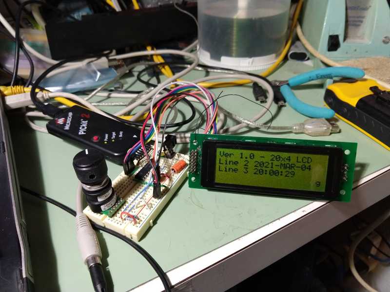

The mystery of why the 16x2 works and the 20x4 didn't is solved :D and it is/was a hardware issue.
And the problem was - the encoder's common pin is taken to gnd via the wiring harness for the 16x2 LCD, when it's unplugged to attach the 20x4 - no gnd connection for the encoder common pin
Just goes to prove there is no such thing as a stupid question.
If you hadn't asked it, I would be sitting here looking up the number for Ghostbusters about now :)
Thankyou for everybody's help through this thread, hopefully I will get the chance to repay it somewhere.
You shared a photo of your setup here's one of mine:
