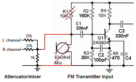

hello everyone i m new to this brilliant forum,
can you give me an idea to make a stereo to mono mixer for @audioguru s miniature fm transmitter?
i want to replace the mic with pc s audio out , it will be the circuit s audio in.
thanks
Remove the microphone and the 10k resistor that powers it.
Add this attenuator/mixer circuit and connect it with shielded audio cables.

He suggested how to mix the L and R chls to make it mono.
