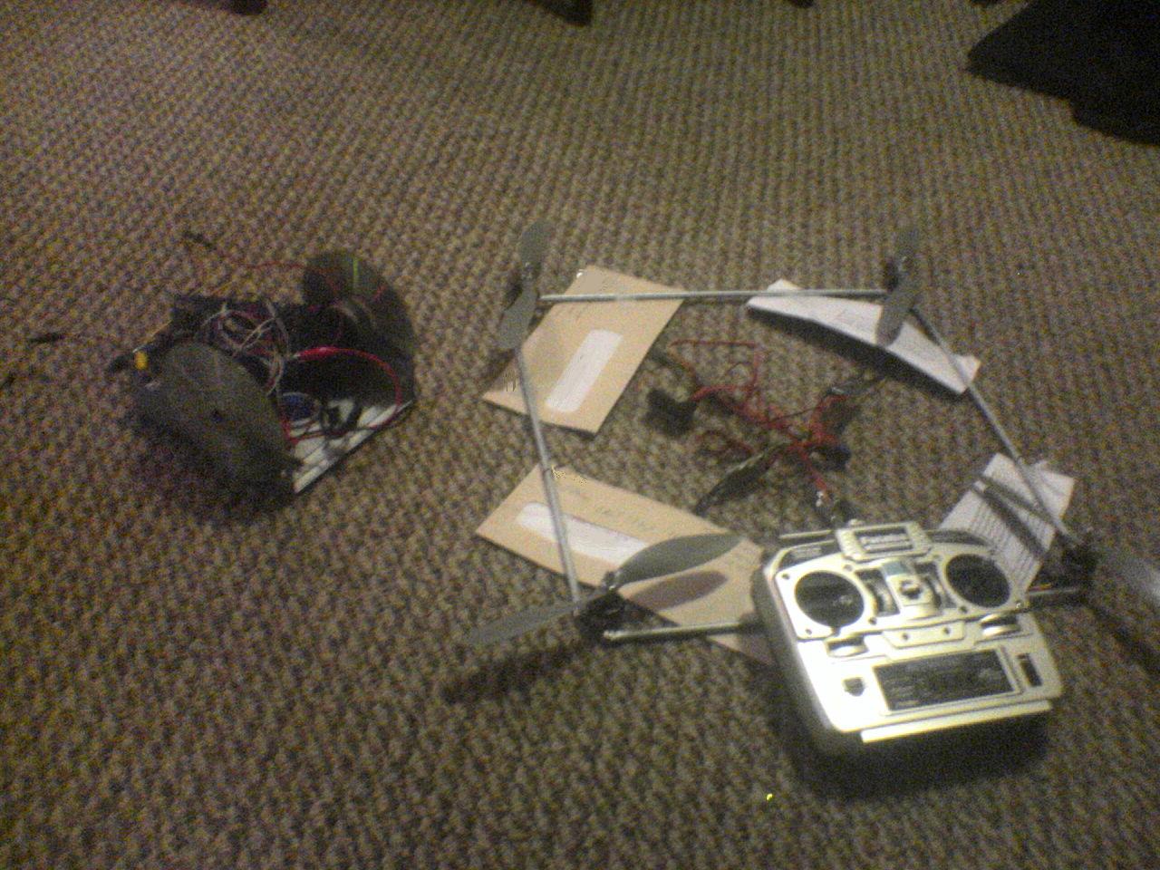

lol,ima teach these lil guys to turn off televisions!
I think you'll have problems with the control systems in the long term =) The motors specifically. nice goal though.
ya, cant fly it with the remote, each stick is per motor, thats why ima let it balance itself, use the remote for a command structure, so when i get PIC i can feed in on 1or2 channels instead of all 4
.......don't know how i'm going to automate height yet ........
Good idea, but you've jumped so far ahead it's not even funny. Little steps.

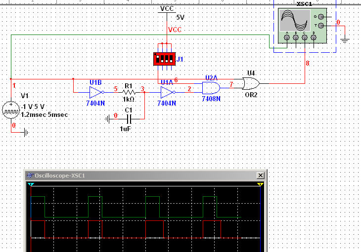

what about this? would it work? I'm using J1 as my balance sensor, and the clock is my pulse signal
.......ohya..... what would happen if i send pulses that have a low off time? ie; a 3ms +/-1ms clock with 50%duty cycle? could a servo keep up with the data with little off time?
