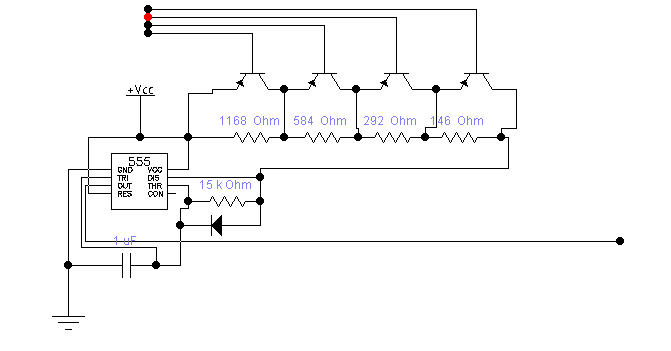

I found this first schematic online , its a servo controller, In the second image i have modified it to adjust the values of the resistor bank to control the pulse timing, using the output of a 4bit counter, would this work? Are the transistors wired properly?
