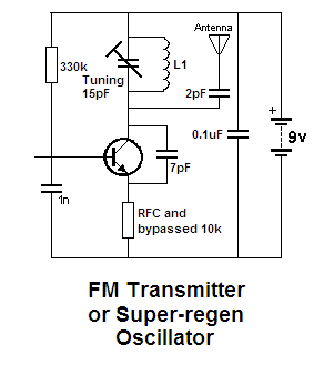

Mstechca,
I don't know why you are changing around all the parts.
The functions of the few parts are clearly explained in the article of the last schematic I posted.
The RFC is not supposed to be a lowpass filter. It is just a high impedance to the RF frequency so that the RF oscillator has more positive feedback through the capacitor from the collector to the emitter, and so that the squegging capacitor does short the RF.

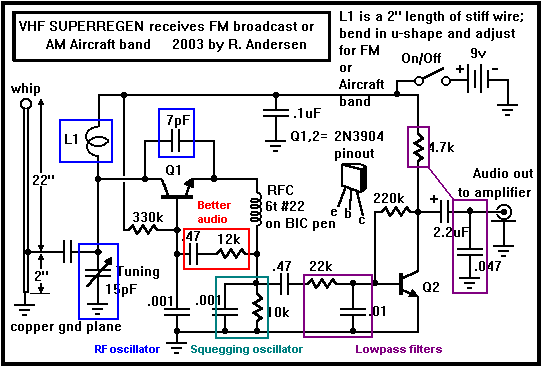

and why am I changing things around? because I want to try to optimize the circuit for local channel 11 TV station.
Do I take the oscillator capacitors (in blue boxes) and calculate them in parallel or in series?

We don't know which circuit you are modifying, but the circuit that I posted can go as high as 174MHz with its tuning capacitor set to minimum and the L1 "half-turn coil" squeezed for minimum inductance. Its 2N3904 "audio" transistor hardly has any gain above 200MHz. So you need less inductance and/or less capacitance and also might need an RF transistor to reach channel 11's 203.75MHz audio carrier. Changing the parts around won't do it.
It should be obvious that L1 and the tuning cap are in parallel. I think part of the 7pF cap and the transistor's capacitance are also in parallel with them.
As we explained before, you can't possibly calculate the tiny values for the "coil" and trimmer capacitor because of high stray inductance and capacitance.
I'm using the 2N3563 NPN transistor. It can go up to 600Mhz.

A 2N3563 has much lower capacitance than a 2N3904 that was spec'd for this circuit. Therefore the value of the 7pF feedback cap probably must be increased for it to oscillate in this circuit. Try 10pF, 12pF or 15pF.
After literally experimenting with this design, I can guess that the following is correct:
L1 and the 15pF tuning capacitor form a low pass filter.
RFC, 7pF and the 15pF form a colpitts oscillator.
as for the section labelled as "better audio", I tend to ignore that because I don't know what value of capacitor to use, and why it optimizes the circuit.
No. Read the article again, its operation is clearly explained.
The circuit is a standard simple FM transmitter with L1 and the tuning capacitor in parallel! The 0.1uF supply bypass capacitor makes the supply voltage exactly the same as ground to RF. It oscillates at the RF with positive feedback from the 7pF capacitor.
No. As explained in the article, the 0.001uF capacitor and the 10k resistor make the transistor an ultrasonic RC squegging oscillator. The RFC is a high impedance to RF and keeps the 0.001uF cap from shorting the emitter's RF to ground.
The cap is charged with a DC voltage by the transistor beginning to oscillate. When its voltage gets high enough then the transistor can't oscillate anymore and the cap discharges into the 10k resistor until the transistor begins to conduct and begin oscillating again. :roll:
