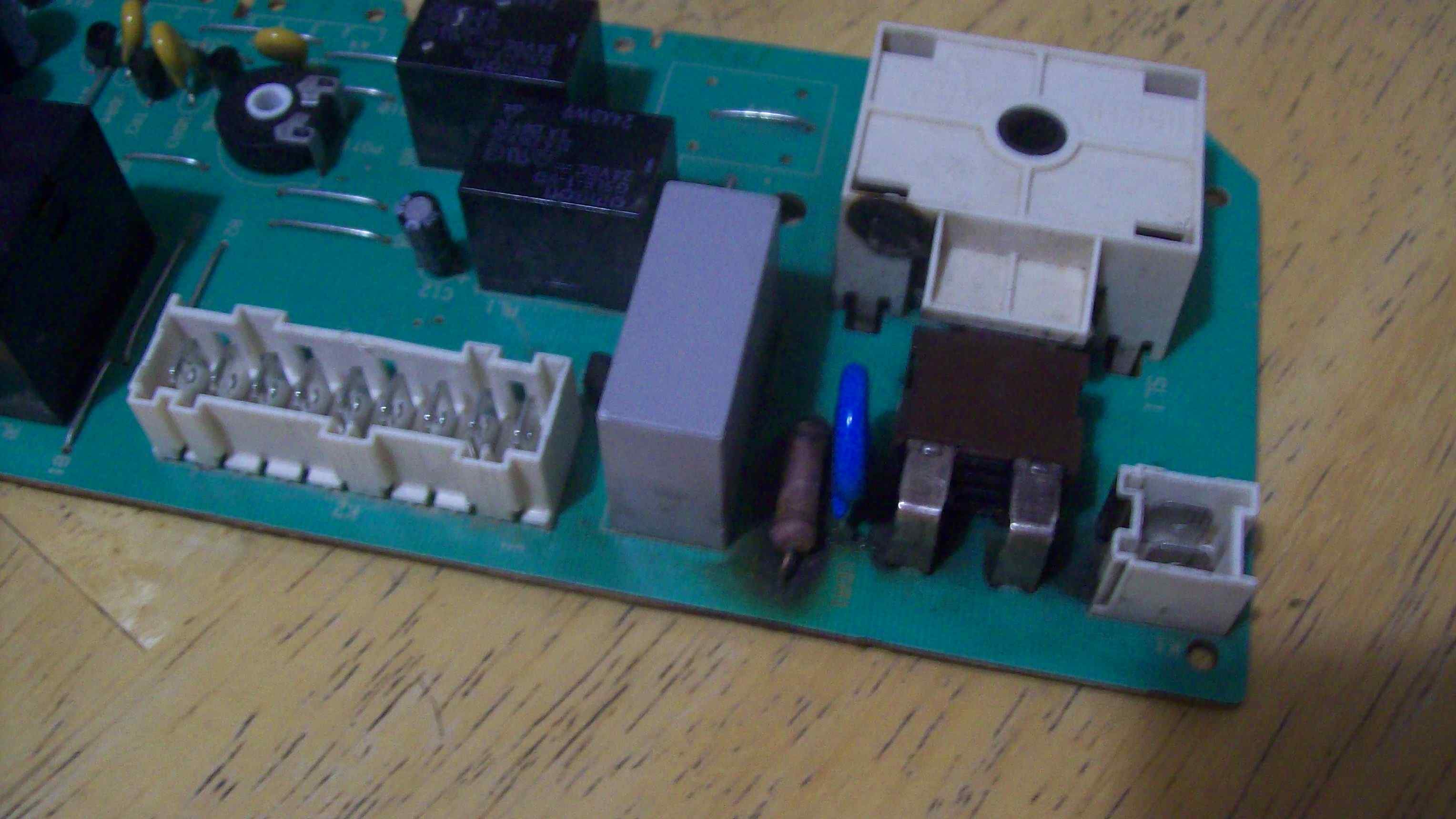

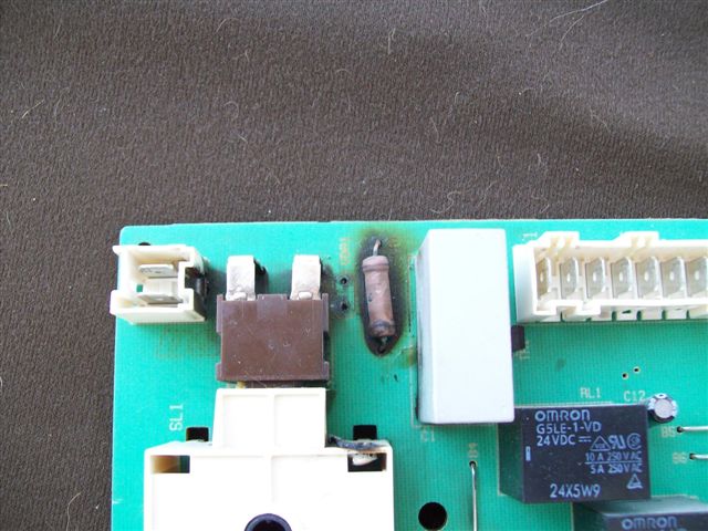

I live in a rural house without hookup to mains electric which in itself brings up its own problems but not least the fact that I have to generate my own electricity using solar panels and a generator! Hence the problem with this circuit board.. I'm afraid it got a belt of high voltage from the generator and refuses to play!

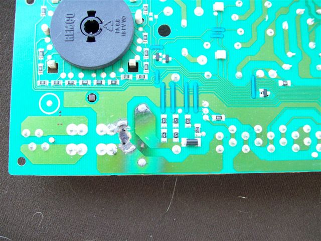

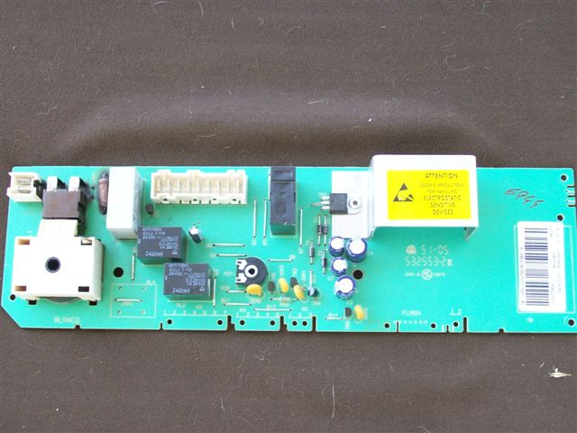

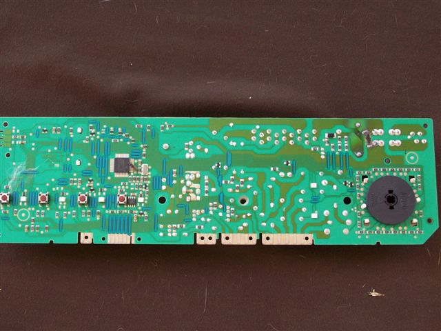

It's the electronic control module from a Bluesky 1030bf washing machine. This controls the programming/cycles on the machine. Please see pictures for the damage..
I've checked for burn marks, solder joint damage etc. and as far as I can see there are 2 affected components.. the resistor (burnt) marked R1 on pcb and there was a capacitor next to it (now removed, was the same as the other capacitors on the board VE09 0301 7Ku) marked VDR1 on pcb which had kind of exploded!
I can't identify the markings on the resistor due to it's burn out. I can just make out that it had 4 maybe 5 colour bands. One at one end is definitely brown, then one at the other is 90% black and there is one in the middle, looks pink now but may have been lilac?
The fault that all this causes is that when I plug the module in it just sends all the lights on and freezes.

My question is, then, would it be possible, for some of you out there, more experienced than myself (!) to take an educated guess about what this resistor would be trying to achieve and hence what it's value might be?

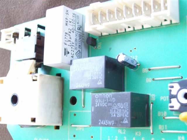

Since some of the pictures were taken earlier and since then I have been to an electronics components shop and they gave me a new capacitor that they said was the same, so I have fitted that and tested the washer again but it still won't start. See the last pic which shows the capacitor (blue, with CNR 14D431K) now fitted.
I have taken the resistor out for a closer look in the past hence the rather shoddy soldering I'm afraid!

The blue thing is not a capacitor. It's a: **broken link removed**
These are used to suppress voltage spikes...and will be destroyed if hit by a high enough and long enough spike. Since the resistor appears to be on the down stream from it and the power input connector (?), my guess is that something further down-stream from the resistor shorted out when the varistor died.

the other component near by the resistor with two legs out seems to be a rectifier pack, normally this type of varistors are used for voltage spikes and to break the circuit during any spike, the ressistor may be for relay operation and still working. better try to find out what are the components and how they are connected.
my sugestion is if you know any one expert just give him mthe board and ask him to draw the circuit of the power control module, then you will get the idea what those componenets may be and how we can fix it back
i have done few times in rare cases the same way to know the circuit components this way.
