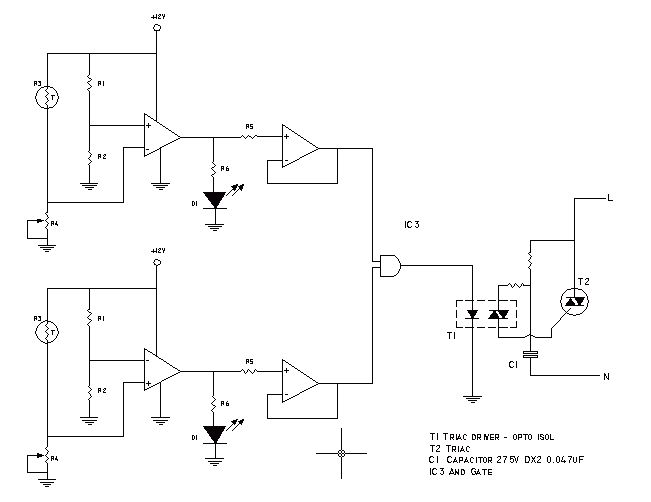

Can anyone shed any light on avoiding inductive spikes when switching inductive loads with a triac. I understand that these voltage spikes can jam triac's open or in worse case scenario damage circuitry.

Thanks for the replies. Just a couple of questions
In the attached circuit diagram, is C1 regarded as a snubber?
By busbar do you mean connector's and/or wiring or the rail on the circuit board?

You need some noise filtering in that ther circuit.
simply put a diode across the inductive load matching it polarity.
Looks like you got the op amps set up for open loop gain, so any stray voltages will be amplified alot.
Can't do that... The load is apparently an AC load - A parallel diode would cause a short circuit on one side of the AC cycle.

His application is with a triac on a AC supply
Why is he using a TRIAC in an AC system then - it will not turn off?

It will turn off at every half cycle, at the zero crossing point where current will fall to zero (assuming no gate signal). Triacs are specifically designed for AC systems!.
true BUT what he doesnt say is what the load current is. The thing aboyut TRIAC's and THYRISTORS is there needs to be a significant period of no current flowing for them to stop ocnducting - I just dont think the zero-cossing in itself is long enough for minority cariier decay thats all
Yes, because he is using the first 2 opamps as comparators where you need the gain, but for any comparator with slow rising signal inputs, you need some hysteresis to prevent multiple switching's at the trip point, as I have mentioned in one of my previous posts on this subject.

Ah well if you think zeners can supress these induction spikes then go here:
https://www.electro-tech-online.com/custompdfs/2004/12/1N6267A-DPDF.pdf
these are unidirectional so they can be wired to deliver in-phase current rated on both sides of the wave.
The device will quickly self commutate once through zero due to the reverse current, with absence of a gate signal

That's how they work!, the load current doesn't really affect it.
