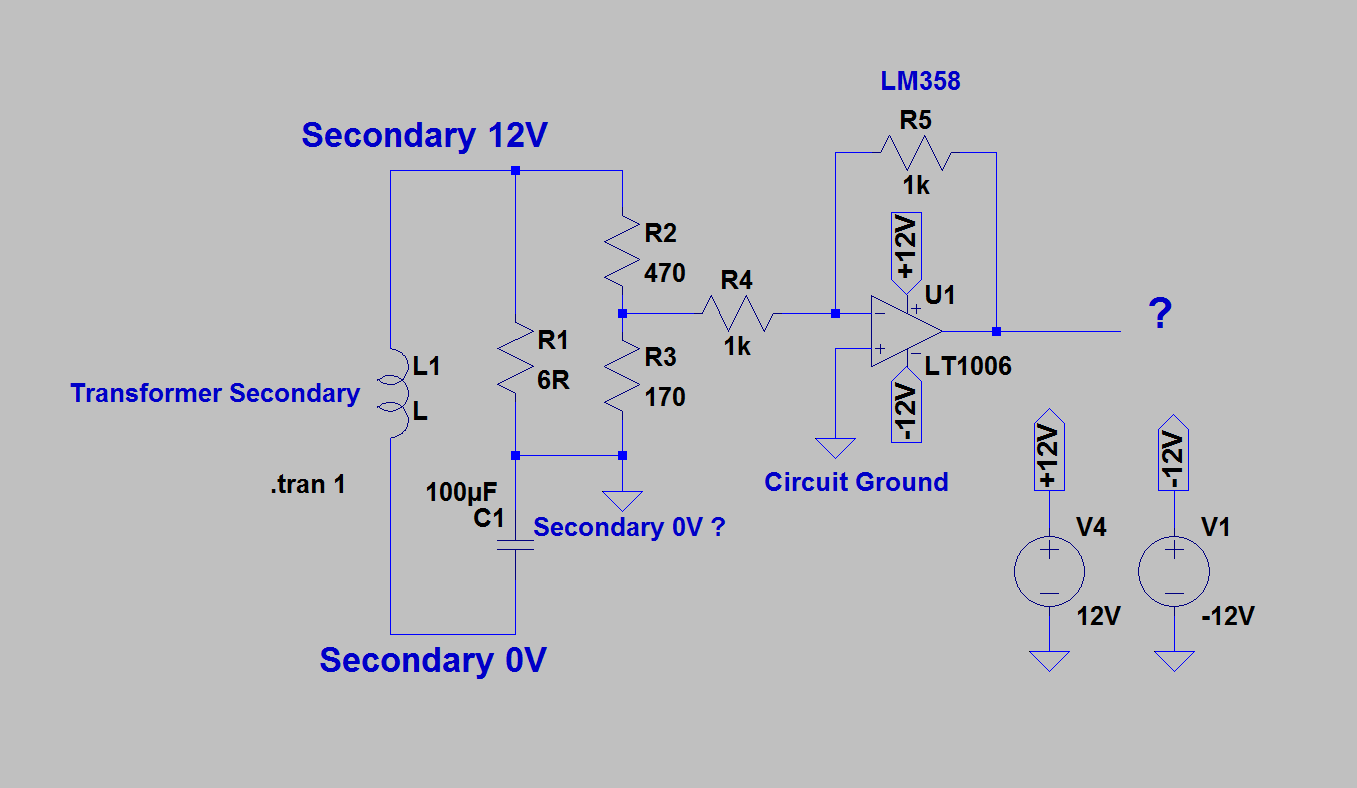

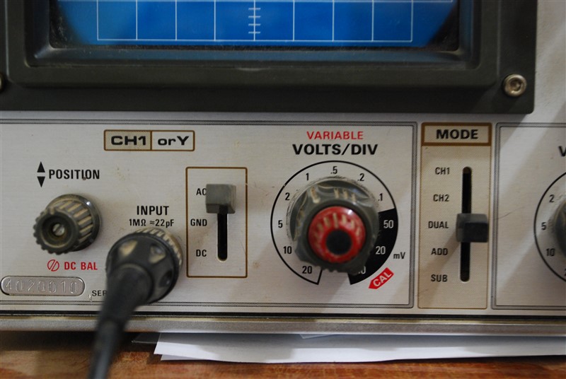

Hi Kiss,
My scope has no invert, I tried what you mentioned.
Please see pictures attached.
Can I make a current probe somehow?
Maybe I can use a Lissajous pattern?
Cheers

OK. It has add and subtract, but no invert. Most scopes have invert. So, you usually do an invert and add which apparently is more versatile. Subtract teaches you "What to think" and not "How to think".
Oh well.
The only real way of handling it, is a voltage divider across the 6 ohm resistor and an inverting amplifier (Gain=-1). e.g. +-12 V supplies and a divider that reduces the secondary voltage to less than +-10 V p-p maximum. Then a protection resistor so the OP-AMP doesn't blow up when it's unpowered.
No big deal to put together.
In the short run, you really should be looking at just the voltage across the transformer / load (RC combo)
Actually, why not try to look at:
The full secondary voltage and
The voltage across the resistor which is current.
The above makes a lot more sense. Everything would be in phase and you would be looking at the voltage and the current like we're supposed to.
Then adjust the gains using both the variable and fixed such that the p-p amplitude are the same on the screen.
Sorry, I misled you.
Hi Kiss,
I just posted this to make sure it is what you mentioned but then noticed your addition to the other post which I will read now.
Did I have it right anyway?
Cheers
Close, but IGNORE the idea. 20/20 hindsight says it doesn't make sense to use it.
Just ground the side of the resistor connected to the transformer.
Put probe A so it's across the secondary.
Put probe B across the resistor.
That will give a voltage proportional to the current through the RC network and the voltage across the RC network. That's what we want.

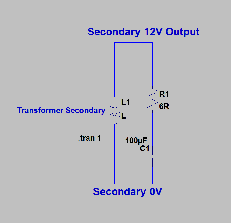

Hi Kiss,
This is where I get a little confused, you mention to "ground the side of the resistor connected to the transformer".
As I see it I have no ground to connect to?
All I have is an Active & a Neutral connection on the Primary side & a 12v & a 0V connection on the Secondary side, sorry for my ignorance?
I have attached a picture of the connections I have, could you please elaborate on how to connect this for the proper readings we require.

Your right, but for arguments sake:
Swap R1 and C1 on your diagram.
Ground the 0V side. meaning the scope sees this as ground.
One probe across R1
Another on the 12 V point in your diagram.
Your correct: the triac in the primary will be different than a triac in the secondary. A triac in the secondary might be the right thing to do, but for now leave it as triac in primry and add a minimum resistive load on the primary side. i.e. A resistor across the primary. R=240/0.1. 0.1 A is probably not optimal. Need the datasheet.

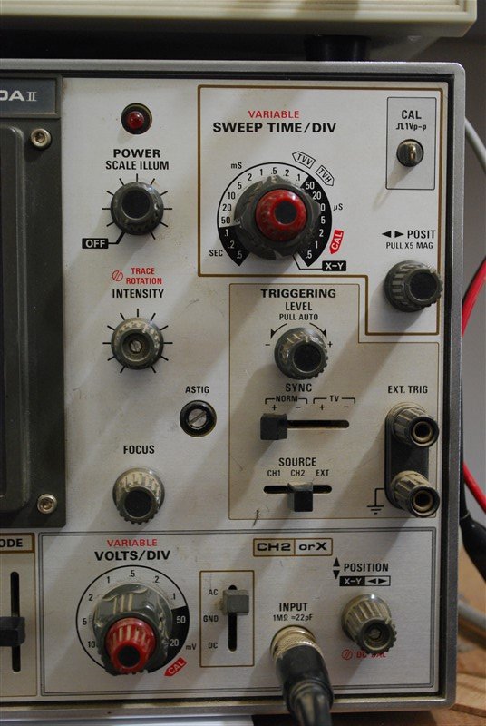

Try line trigger and use the slope and level controls.

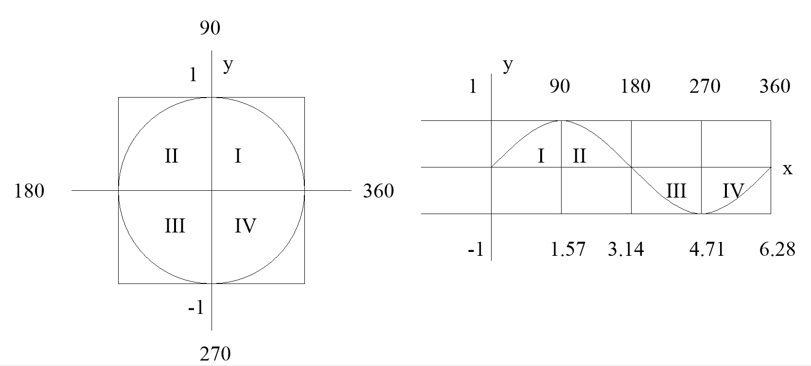

You need a quick math lesson. The definition of Quadrants. See: http://www.math.com/school/subject2/lessons/S2U4L1DP.html
Operating in quadrant I and quadrant III is a resistive load. The I, II, II and IV are roman numerals.
OK, so what does quadrants have to do with Triacs?
When you look at your datasheet:
I am using just a BTA16 600B for this testing at the moment Data Sheet here:
http://pdf1.alldatasheet.com/datasheet-pdf/view/22033/STMICROELECTRONICS/BTA16-600B.html
There is a column labeled quadrant.
In order to operate in Quadrant IV (4), you need twice as much current.

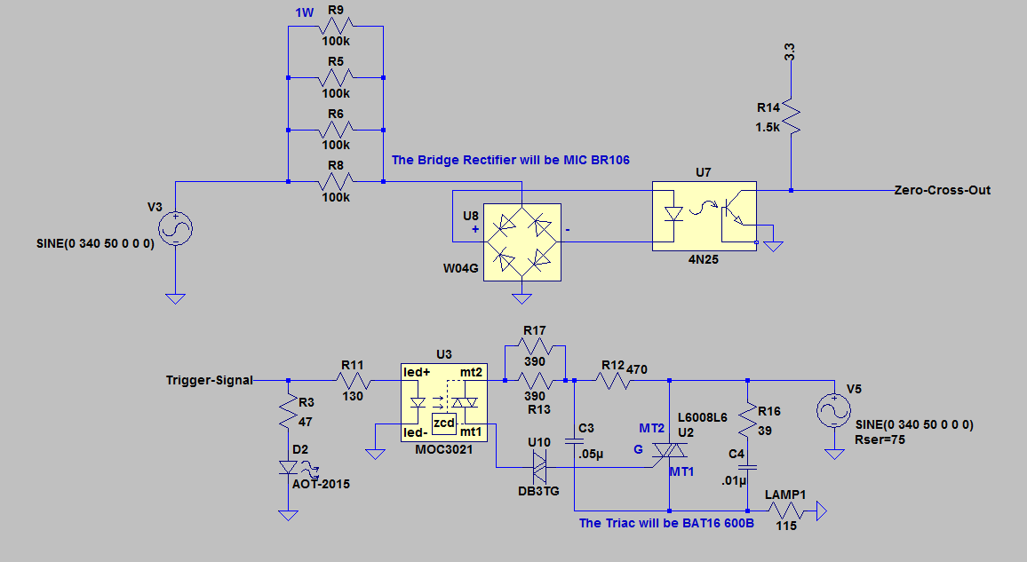

Post your drive circuit.
The thing is, I don't really like the datasheet. It's a complex relationship that I need to brush up on.
There is a Triac called a "sensitive gate triac" too.
Your trigger circuit probably can't dump 100 mA into the gate?

The drive circuit attached, I have a cd40106 after the 4N25 which is not shown.
I'll go through what you have mentioned & get back to you.
I'll get this no matter what!

Hi Kiss,
First up before I go to far on the wrong track, is this how the Quadrants you mention relate to the sine wave?
This is bad you know on a forum showing everybody how much I don't know at my age, it can be nothing but character building.:confused:
I find it's better to draw things with the way my head is these days.
Cheers
