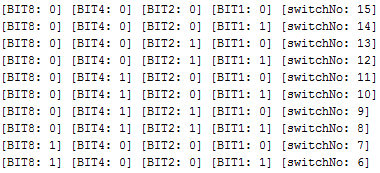

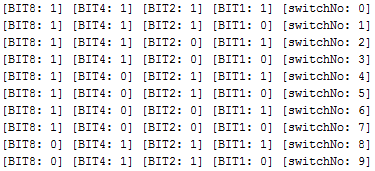

Ok, onto the Sketch, I tried the new sketch you posted & still get the same result as the first original sketch, I have attached a serial shot named:
"ULN2003 +5V New Code", test was from 0-9 on the switch. The Output is still inverted.
I tried many other things today with no luck but I don't really know what I am trying to get, I thought 0-9 is what we wanted, isn't this BCD to Decimal & what we need?
So if we have two BCD switches & select say 20 with them the Arduino will see 0010 0000, this is where I am confused now, what are we looking for & why?
Anyway, I tried "+5V to Common" instead of "common to ground" & used 10k resistors to ground without the ULN2003 & have attached a serial shot of this as well named:
"+5V Common Original Sketch", again the test was 0-9 on the switch. The Output is not inverted now, not sure about the switchNo though?

Congratulations!
The first one is PERFECT! It's EXACTLY what you want!
It can probably be cleaned up (done differently) and shortened, but it's not necessary yet. Eventually you'll want to move it into a function form.
The only way of changing the pattern is add inverters or buy the complement switch. Both are unnecessary. Although, it may be easier hardware wise later if they were inverted.
So, now, you can take switchNo and multiply and or divide and add to get any digit of the setpoint.
e.g. switchNo*10, switchNo, and switchno/10

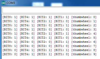

I think you called it "thumbwheel" rather than "switchNo" and that didn't register that as a computed number. Probably migraine again. The delay should have given it away. It gave you time for you to change the switch. I changed + to a bitwise OR. :arghh:
Hopefully, the instructions will go well.

And maybe change switchNo to Thumbwheel because it may be a better name and make it a function because later, you;ll have to do something like:
