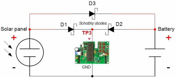

My solar pannel open circuit voltage is 7.5V and i am using a 2.3V rated super capacitor of which im taking through a boost converter to provide 5v for the micro. The charging voltage of this capacitor i think is 2.3V so with the schematic in the picture that i've attached.. wont the solar pannel harm the super cap whilst charging... i'm confused about this.... should i buck it maybe???
please advice :(

You only need one diode (the one on the top). From the bottom two diodes, remove (open) the left one and short the right one.
A panel with Vmp of 7.5 should be able to charge the capacitor up to about 8V (7.3V after diode drop). This is not good for 2.5V capacitor.
If you want to stay with these voltages, you'll need some sort of controller. You can use a voltage limiting controller, but it'll waste (7.5-2.5)/7.5 = 67% of the available energy. Or, you can build a buck controller to downconvert the panel voltage.
Or you can use 3 capacitors in series. The voltage will go to 7.3 while charged, but it'll be dropping to lower levels during the night.
Batteries are more suitable for storing energy because they provide a steady voltage while capacitor's voltage decreases as it discharges.

Dump the super capacitor, they are pretty useless devices, and replace with a proper battery - 4 x AA NiMh should be fine?.
Then simply connect the battery to your micro-controller circuit (no boost converters or regulators needed), to add solar power simply connect the panel via a diode directly across the battery.
That's all you require, one single diode - based on the little you've told us.
