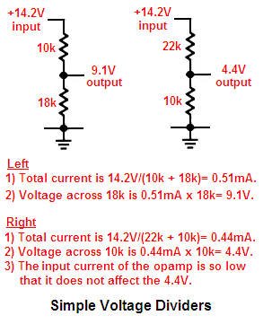

tach signal and F-V converter
The IC that he is using requires an input that goes positive and negative. The tach signal might go only positive and 0V. Then the input of his IC will not work unless a coupling capacitor and resistor to ground are added.
it is square wave, 14.2v - 0v .. the datasheet provides some sample circuits but it does not provide the capacitance of the "coupling capacitor", I used a 4.7uf 35v
I used a -8 instead of the -14 b/c i didn't know that they were different. after i burnt the first chip I looked around and found the -14's and ordered 3 of them (not cheap at all).
they looked basically the same in the PDF datasheet so I thought I could make a smaller circuit with the -8's so I tried it. It did work and I drove around with it but then it died. I am thinking maybe the zener diode I have is the wrong size also, is there any way to test it (I suspect it is the culprit b/c it worked until I killed the car which sounds like maybe an alternator spike from what I have read)?
I will buy a new diode when the chips come in.
Did you read these notes in the datasheet?
If you use the 14 pins version then I was wrong, a coupling capacitor is not needed.
Connect the 0V to 14.2V signal to the filter and voltage divider. Connect the output of this filter and attenuator to input pin 1.
Make a nother voltage divider to reduce the supply voltage to half the signal's max voltage at pin 1 and connect it to pin 11.

If I'm understanding correctly, I still use my tach input to the 4.7uf cap run that though the 10k resistor to pin one and back off pin to ground using a 20k resistor and .02uf cap. Then measure the actual voltage at pin 1 (or what would be pin 1 after assemble?) after that circuit has been built take my primary supply voltage and run it through a resistor to pin 11 and from pin 11 back to ground, and that voltage should be approx 1/2 the measured voltage at pin #1.
I do have a couple questions here, how do I know what size resistors to use, b/c I'm sure several different combinations will result in 1/2 voltage. It does say something about 3mA...
#2 is on the datasheet it counts (in several places) 11 - 12- 10 -9 - 8 ... won't pin #11 always have a full ground, is it pin #12 you mean or is my datasheet wrong (having 11 & 12 swapped), or ... actually set pin #11 at 1/2 trigger voltage??

The 4.7uF input capacitor in your first schematic has its polarity backwards. Your tach signal is a positive voltage and should connect to the positive wire of the 4.7uF capacitor.
The capacitor is needed only with the 8-pins ICs. The capacitor must not be used with the 14-pins ICs.
Your tach signal goes up to 14.2V. The 10k and 18k at the input resistors attenuate it to 9.1V.
Connect one 22k resistor to the positive supply voltage and pin 11. Connect a 10k resistor from ground to pin 11. Then the two resistors divide the supply voltage and provide about 4.4V at pin 11.
The schematic shows what the pins do. They are not in sequence. Pin 12 is the ground pin of the IC. Pin 11 is a reference voltage for the opamp and can be any voltage that you make it (within the power supply voltage range).
6000 ERPM (8 cylinder engine)[/I]
6000 ERPM should be 3000 pulses per minute... which is 50 hz on an 8 cylinder engine, right?
Yes.
further reading says I can "clamp" the output voltage (pin 5& 10) with a resistor back to V+
It is not shown in my National Semiconductor datasheet and is wrong.
if I follow this diagram won't pin 11 always have zero volts or is a diode not "absolute" and acts as a resistor in one direction (I must assume)
The 10k resistor turns on the diode continuously and provides a voltage of +0.7V.

Ok, pin #11, with the diode it is .7v ... what do you fellars mean by this:
it will be triggered by a voltage more than 0.7
what voltage should it be, 1/2 of my KOEO voltage of 14.2v
How does 10k & 18k = 9.1v? ie, how do you calculate that?? i tried 10k/18k * 14.2 = 7.8 ...
If you use a diode that continuously has 0.7V across it as the reference voltage for the opamp then the circuit is triggered whenever the input voltage goes higher and lower than 0.7V (plus a small voltage for the hysteresis). But since 0.7V is so close to 0V then noise that is more than only 0.7V will also trigger the circuit so I selected a reference voltage of half the input voltage.
Ohm's Law is the most basic rule in electronics.
Use ohm's Law to calculate the current in the two resistors in series then again to calulate the voltage across the lower one.
