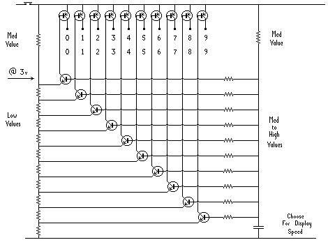

Hi boolagoosh,
You say you want to create a device for this?
I wouldn't be surprised if there isn't already something available.
You could probably purchase programmable chips that would give
the result you want, i guess the extra tail-light is quite a bright
set of LED lamps, so they would need extra boosting from whatever
'cascade' unit you make anyway.
This is the sort of approach i would take to give the result
you describe.
The bottom part of a charging capacitor's curve is fairly linear,
so ive guessed at about three volts, but you might want it
non-linear!
The circuit is not finished, it is only a suggestion, you
would have to sort the details, its just the sort of way i would
go about it.
It might be easier to buy something ready-made
than to create your own.
Regards, John

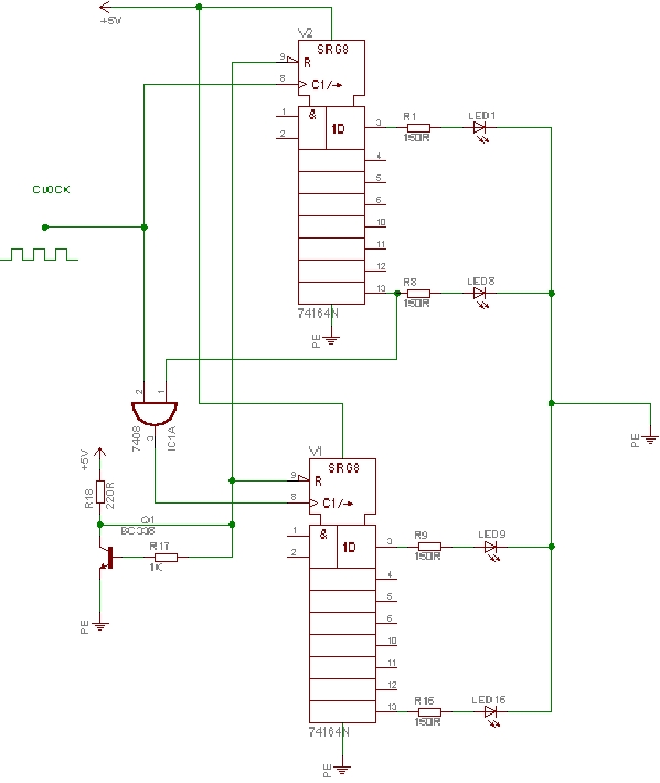

Hi, Boolagoosh,
The attached diagram shows how to wire 16 leds to light up one ofter another. First led remain lit till the 16th led light up and all of them go off then the cycle restart. Of course you've got to wire another parallel row of 16 leds for oposit direction.
I think this is exactly what you want.
hope this will help your project
regards,
I think the above circuit will only lit the LED in sequence but he also wants them to go off in reverse sequence and I don't think this will do the reverse thing.
Sure, that the circuit will lit the LED in sequence only. All leds go off at the same time, not getting them off one by one in reverse.
But Boolagoosh didn't mention the reverse effects anyway.
I think it can also be done but not with this circuit. i have idea to obtain such effect with circuits contain tristors, transistors and IC Combination. But it still need to be work on it.
Ofcourse he has mentioned the revese effect. See: 123456789 and then 987654321
ok you may be right but i thought he wants leds should be put on 2 by 2.
both 9th led will be lit at the same time and then 8th and then 7th
so he would have two running light proceeding to oposit direction since he said " I want the 9s to light up first, joined next by the 8s, then the 7s etc........"
anyway it may help to somebody else if boolagoosh didn't mean what i mean
sorry,
from what i see the order, its like putting the leds in circle and one led lights and then another.....but some leds remain lit up for some time afer they had lit.

Hi boolagoosh, kinjalp, bogdanfirst, herbymcduff,
Sarac, and any others looking in,
Apparently 'Halfords', a popular car-spares shop
sell ready made units to do just this effect.
This would probalbly be cheaper than buying all
the bits, and a case, and spending the time to
build one yourself,
But projects like this are usually taken on where
the person wants to make it themselves, people
are usually aware that ready made items are
available.
Building something from discrete components is a
far cry from programming nested loops into some
programmable chip, that may not be what he wants.
As to the reverse effect,
it is assumed that they will all go out, wherever
they are in their sequence, opon release of the
brake pedal. That seems logical to me.
Sarac is correct, the circuit as drawn, is for
lighting the LEDs in the manner described, they would
all go out together.
Also as mentioned, the circuit is only a skeleton,
only a suggestion, it may be found that high to med
value resistors need to be put between the base-
emitter junction of the outputs, to keep them shut
when not being driven, if the leakage from the drivers
is a bit high.
And the cap doesnt want to be too big, cos it has to
empty fairly quickly when the supply goes off, it
would be feeding the LEDs so it would empty quickly
anyway, i mention it because there are capacitors
available which are such massive values that using
a very large value could actually make a visible
delay between releasing the brake, and the lights
going out. Unlikely, but best mentioned.
For someone wanting to 'learn as they go' such a
project is fairly good, easy to fault-find, no
RF, no dificult to understand parts, moderately
easy to understand, and gives a visible result to
satisfy the constructor.
John
