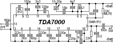

I tried asking harry about how to make the antenna, but havent got a reply 2 weeks, so ill ask here. I was told to make a diple aerial antenna, but have no idea how to go about doing this. I added the circuit that im building. Ive searched the internet dry and cant come up with anything that would really help me. If someone could point me in the right direction or tell me how to do it, it would be greatly appreciated.
Also, ive lately been trying to figure out impedance matching. i think i basically get the main idea, but would like to be able to put it to use. Could someone point me to a good website?
And would it be safe to suply this circuit with 9 volts? I like using 9 volt batteries :lol:
Thanx :lol:

Hi Zach,
He says (I couldn't find the datasheet) that the TDA7000 works with a supply voltage from 2.0V (worn-out two alkaline cells), to 10V which is a brand new 9V alkaline battery.
Have you ever seen the small size of the cells inside a 9V battery? They surely won't last long. Compare the size (and spec's) of those tiny cells with AAA or AA cells. Two AA cells aren't much bigger than a 9V battery but will last at least 6 times longer, and are cheaper. Your choice.
I don't like 9V batteries anymore, I'm designing thingys for 3V now.

Have you tried googling for 'dipole aerial design', there's loads of hits!.
But a dipole is just two rods, you can easily make one from a piece of twin speaker wire - get hold of the two conductors, one in each hand, and pull them apart until your hands are fully stretched out sideways. This gives a dipole about the correct length for VHF radio - the other end of the wire connects to the two connections on the radio.
If you want to calculate the length of the two rods, pick a frequency in the middle of the FM band, or a specific frequency you want to receive, and make each rod a quarter wavelength long.

A dipole is the reference value for all aerials, you can make it shorter, but it won't work as well as one the correct length, so iy will have a negative gain value. A yagi is just a dipole with extra elements added (reflector and directors), it gives gain by making the aerial directional, and thus have a positive gain value.
If you want the best performance make the aerial the correct length, if not, shorten it to where you want, but be aware that performance will fall accordingly.
