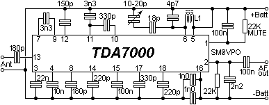

i have a tda 7000 at home that my dad bought a long time a go and it is just sitting. i never so much as touched it. can someone send me a full schematic on how to make a fm radio with non-crystal tuning. i really dont like crystal tuning. thanks.
Hi Dustin,
Google links to many TDA7000 projects. The IC needs only a single-gang variable cap for tuning. Zach is building this one:

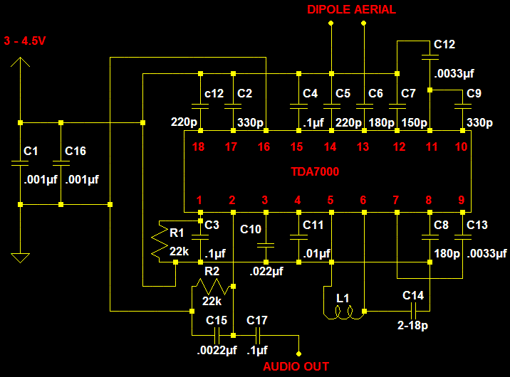

Well, i finished the circuit. I found out that the LM386 circuit was crap, or else i am doing it wrong. I think it is overdriven because it makes A TON of noise and oscillates n stuff. But then i figured out i'd just connect it to my computer speakers until i make myself a decent amp, and that works just fine.
This picture is EXACTLY how i have my circuit put together, and I just want to make sure that I haven't done anything wrong.
So did i put it together correctly? Also, will the mute feature make me not be able to hear very weak signals? I've still gotta mess with the LC values, but ill let you know when ive got it working. :lol: Oh yeah, and on this other picture here, I only see 1 antenna, i thought its supposed to be a dipole??

Progress!!!! I got the LC values right, and have it tuned to the FM band. The thing is, I believe that the mute feature is indeed screwing up the receiver because I can only get one station, and I think that that station is located near to my house. I need to know how to disable it :lol: . I also picked up my FM transmitter flawlessly.

Where did you get its schematic? It differs a bit from the datasheet. The datasheet shows a 10K resistor for R1, yours is 22K. With 10K, the muting is supposed to be disabled. Disconnect R1 with the switch that they show, and it mutes. It reads backwards, but that's what they say.
The datasheet also shows a 10nF cap connected very close to pin 5 and the coil, to ground. Add one, it might help it to work better.
Your value for C15 sets it correctly for the North American de-emphasis response curve.
Speaking about datasheets, did you make the LM386 amp exactly according to its datasheet? Some people leave out the very important series RC network at its output. Without that network and a high impedance load or no load, it is guaranteed to oscillate.
Haa haa, i didnt realize until now that the receiver from the data sheet, and that one from harry's website are one in the same :lol: . I will try the 10k muting disabler resistor. On Harry's, it is a 22k. I will also try the 10nf @ pin 5.

The picture in black is one that i made with SWCADIII. I wasn't sure if I connected the LC circuit correctly so I made that picture to verify.
Oh yeah, and lastly, what is the North American de-empasis respnse curve??
