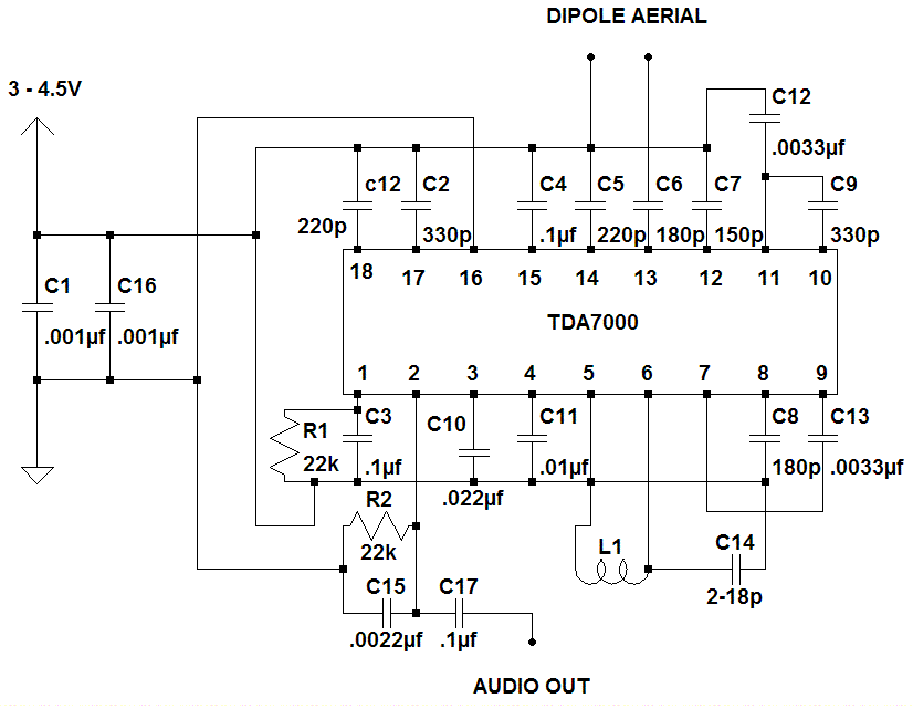

Hi Zach,
When they designed the FM broadcast band system, they wanted to have a very quiet background sound level, even better than the fairly low noise (high frequency hiss) that FM provides. So they decided to emphasize (boost) the audio high frequencies when they transmit, then allow the receiver to cut the audio high frequencies back down to normal. When the highs are cut, then the hiss is also cut. The Americans, who started FM broadcasting first, chose an agressive emphasis curve so that the hiss was reduced very much during de-emphasis by the receiver. The recorders and microphones at that time didn't have much high audio frequency level anyway.
Years later, the Europeans decided to broadcast FM too, but noticed that the high audio frequencies frequently overmodulated the transmitter when they were emphasized so much. They realised that recording machines and microphones had improved very much over the years since the Americans developed the system and produced high audio frequency levels that were much higher than the system could support. So they chose a less agressive emphasis curve (less high audio frequencies boost).
Therefore the North American and European curves are different. An American radio will sound muffled in europe, and a european radio will sound too bright in America.
Your radio has the agressive American de-emphasis curve where the high audio frequencies are cut quite a lot. (The datasheet has the european curve). However, your simple transmitter doesn't have any pre-emphasis to balance the sound so the radio will play it very muffled, similar to your home stereo having its treble tone control turned all the way down.
Hi Zach,
Sorry, but what do you expect from a transmitter for less than a buck?
You could try removing or reducing the value of the de-emphasis cap C15 in your tuner. Then the sound from your transmitter will be normal but the tuner will be noisy, and regular broadcast stations will sound extremely bright (similar to having your home stereo's treble tone control turned all the way up).
Whenever I see your good-looking schematic, I think about running out of black ink in my printer. Can you "negative" it?
Zach-if I am not mistaken the antennas for my Sony armband type radio are the leads to the earphones. Clearly they would be far from an ideal antenna but the 24 or so inches of wire are better than nothing.
there ya go. i dont have a printer so i didnt even think about that.

Hi Zach,
Sure your radio is going to transmit its local oscillator (its coil ) to another radio, it isn't shielded.
Your radio's oscillator frequency is only 70KHz away from its receiving frequency. Normal (super-heterodyne) FM radios have their local oscillator 10.7MHz away. Big difference.
You didn't say before that the radio hums, and now you say that it also transmits that hum. It shouldn't hum.
Are you powering it with an AC-DC power supply? Even if you are using a battery, try adding a 100uF cap across the radio's power supply input. It might stop the hum (AC ripple) or change its pitch (motorboating).

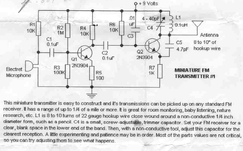

YEEEESSSS!!!! IT WORKS!!!! Beautiful clear reception!!! I want to test it with my bug, but something is wrong with it. Hmm, maybe you can clue me in :lol: .
Here's the schematic. I was told by john sorenson to use a 15pf cap for C5, and thats the only thing i did differently from the schematic. The thing is, it hums, and the sound quality is realy bad. It used to work just fine. Where do you think the problem is?

Hi Zack,
I am confused. Before you said that your radio hums and it transmits hum to another radio. Now you say that your transmitter creates hum. Which is it?
All battery-powered electronic items work better with power supply bypass capacitors, especially when the battery is low and has a high resistance. Maybe now your battery is low. On your transmitter, add a 0.001uF to 0.01uF ceramic cap across the battery connection to the circuit for RF bypass, and a 10uF to 100uF cap in parallel, for AF.
Maybe your transmitter hums because its electret mic is connected backwards. Then its case would be "live" instead of ground. An ohm-meter to its case will tell you which terminal is ground.

Sorry, i shouldve been a little more specific, it is two seperate things, my receiver was doing the hum, but now that is fixed, but now i am talking about my transmitter.
The batt voltage is 8.58v. i would think that would be high enough. maybe not. ive got a .01uf cap across the battery. havent tried an AF cap though. Umm, how do I use my ohmeter to tell me which way is which on the electret mike?
The ground pin is connected to its case, and you will measure zero ohms. The output pin of the mic is connected to the drain of a turned-off FET and will measure a high resistance to the case.
right you guys were :lol: . just had to turn it around and i got much better sound quality/sensitivity. Its funny that the transmitter had fine sensitivity when the battery voltage was higher.
