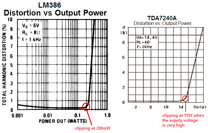

Does every amplifier have an input threshold? When I turn the music source volume up past a certain point, the sound from the amplifier begins to distort, before it seems to reach its max volume. This also happens with the smaller lm386 amplifiers i built, is this because it has reached its peak power? Thank you for all of the help.

It's not an 'input threshold' as such, more an output one if anything - the output level is constrained by the available power supply voltages.
The datasheet for the LM386 shows that when it has a 6V supply and an 8 ohm load it begins to distort (clipping) when its output is only 0.2W which is not loud.
The datasheet for the TDA7240A shows that when it has a 14.4V supply and a 4 ohms load it begins to distort when its output is 15W.
Every amplifier clips (distorts) when its input is turned up too high.
Alright, thank you. Since I have an 8Ω speaker at 12V, is the clipping around 12W?
The power into an 8 ohm speaker is shown to be a little more than half the power into a 4 ohm speaker.
The power into 4 ohms with a 14.4V supply is 15W at clipping. It is 20W when the amplifier is clipping very badly with 10% distortion.
The the power into 4 ohms with a 12V supply is 10W at clipping. (Less voltage produces less current which gives less power)
Then the power into 8 ohms with a 12V supply is 6W at clipping.
A manufacturer would rate this mono amplifier at 80 Whats!
With a 16V supply a TDA7240A will produce 11W into 8 ohms at clipping.
