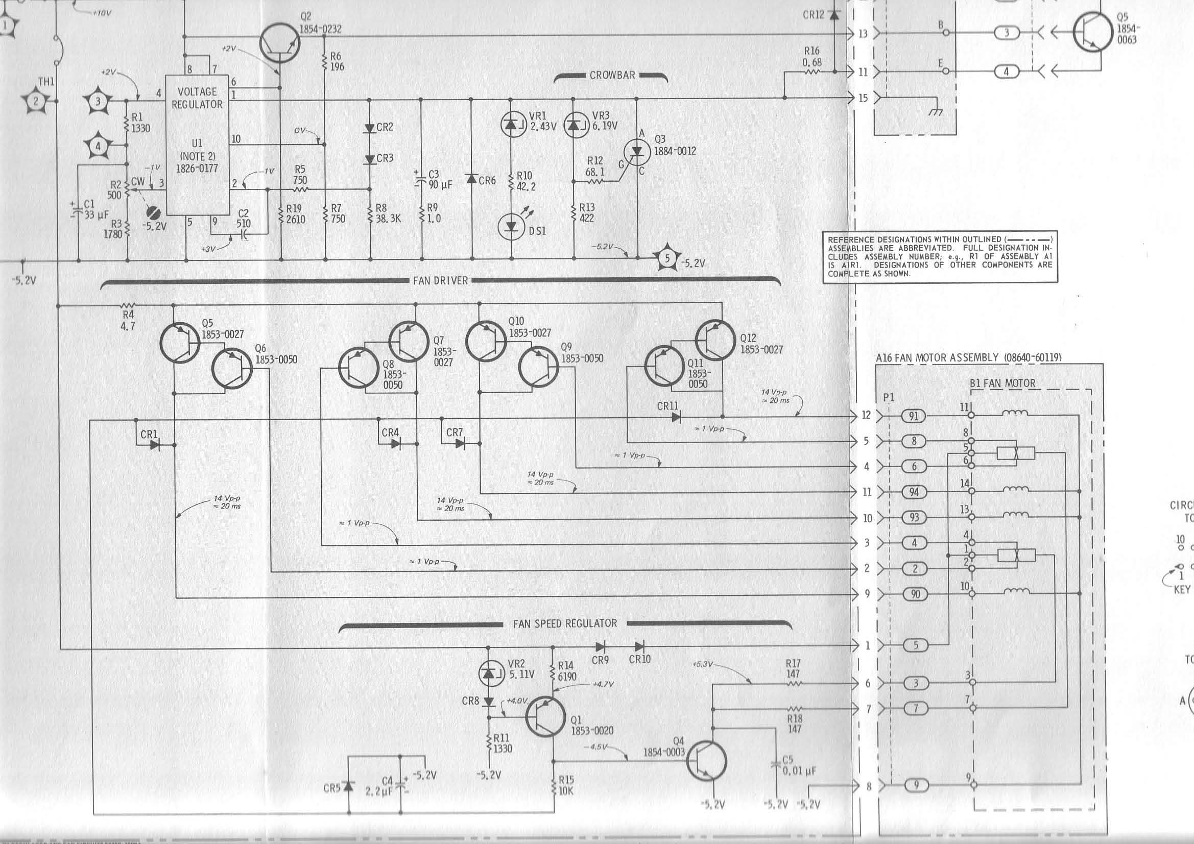

My TEK 564 has a simple lamp brightness control but this thing dates from 1960.
It has a big 3W wire wound pot and a 3W wirewound resistor to make it work. Actually, the 564 gets hot enough to cook toast. All those series regulator valves and ballast resistors. As bits and pieces fall over, the thing gets redesigned. The series regulators are now replaced by FET's. The original 6080 had a 15 Watts of heater power.
By contrast, the 'over-engineered' design has low cost potentiometer and a ULN 2003 IC.
Cost wise, and based on RS prices, a 3W wirewound pot is say $15 and a small half watt pot is $7. Add a 3W resistor at say $1.50, and the 'simple' design costs about $16.50 and the 'OTT' costs about $8 for the cheap pot and a ULN2003($0.75). Of course, factory purchasing would give different costs, but the comparison is probably valid.
So the design choice is based on cost, and the extra complexity in manufacture disappears with the way the parts are assembled with flow soldering etc.
Sometimes too, the apparent 'OTT', is actually a part of long term design/development gaining exercise, to assess various design topologies. In the example given for the HP fan control, this looks like a variable speed stepper motor type of arrangement, and again, it is almost certainly cheaper than a commutator type fan motor set-up. So what seems costly and 'OTT' can actually be the reverse.
