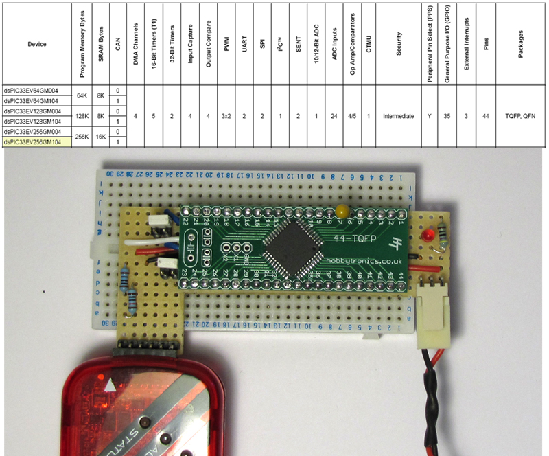

My solution was a PIC sandwich , dsPIC33EV256GM104 on a TQFP adapter all the caps / Vdd ,Vss ICSP connections on a perf- board below , most pins available will go straight into BB . 5 volt I/O @ 70 MIPS ... cost <10 GBP
Edit ... The 2 resistors on PK3 pin 1 and 2 (reset/Vdd) are shown incorrectly ( see comment below) .
My solution was a PIC sandwich , dsPIC24EV256GM104 on a TQFP adapter all the caps / Vdd ,Vss ICSP connections on a perf- board below , most pins available will go straight into BB . 5 volt I/O @ 70 MIPS ... cost <10 View attachment 91653 GBP
How did you get the PIC, components, and board all purchased/manufactured for <$10?
EDIT: Wait, was the TQFP adapter pre-manufactured? Or did you make that yourself?
Hi .. The pic was from Farnell aproximatly 5 GBP , 44 - TQFP .. UK Hobbytronics 2 GBP + caps and strip board... I'm just amazed at the PIC24 family works well with MPLABX and PK3 . Wish my C was up to scratch.
Looks nice. I am curious about the two resistors from the PK3. It looks like you have a divider between Vpp and Vdd.
As for decoupling caps and similar required caps, one of the pleasant surprises from a recent development/adapter board I got was that they were included. I don't seen any reason they shouldn't be included.
John
John... Well spotted ... I took picture when I had the resistors the wrong way round ,:mad: this was corrected ... now PK3-1 100R to Memclr pin and Vdd 10k to memclr pin... ( sorry no prize )

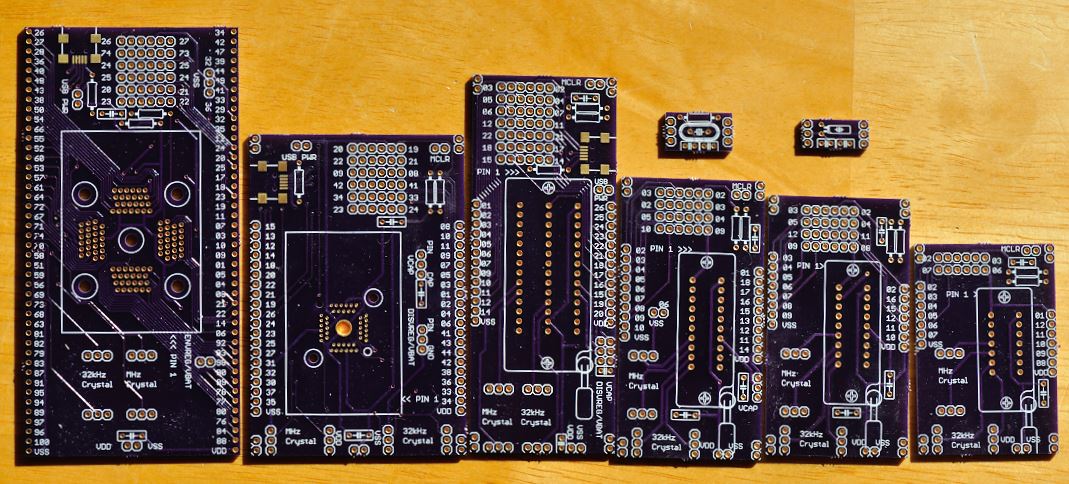

Here's my PIC test boards for PIC24 series (left to right 100-pin, 44-pin, 28-pin, 20-pin, 18-pin, and 14-pin), also little boards to add crystals:

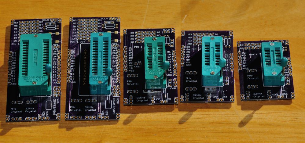

And here are the smaller ones populated with ZIFs:
