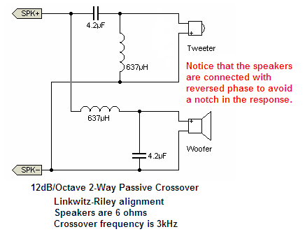

You have only a woofer and a tweeter so you need a crossover network for a 2-way speaker. It has only one crossover frequency, usually about 3kHz to 4kHz.
But you made a crossover for a 3-way speaker that has a midrange driver therefore the crossover has two cutoff frequencies: 1kHz between the woofer and the midrange and 6kHz between the midrange and the tweeter.
A typical crossover network is second-order so that the slopes drop at 12dB/octave.
But you made a first-order crossover that has slopes of only 6db/octave that are nearly useless.
Here is one of many articles found in Google about speaker crossover networks: **broken link removed**
Here is a very simple 2-way second order crossover network:

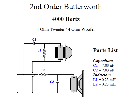

Before go out for the market I already contacted the dealer for the 2-way crossover network but they told me that it will not be available today may be a couple of days later. But 3-way cross over network is available as I will cut down the midrange connection to make it 2-way crossover network. Am I right ? I never give up and I will do it in time. Put your views about my thinking !
Can you tell me the usefulness of this crossover network for my speaker system ?
Thank you !
