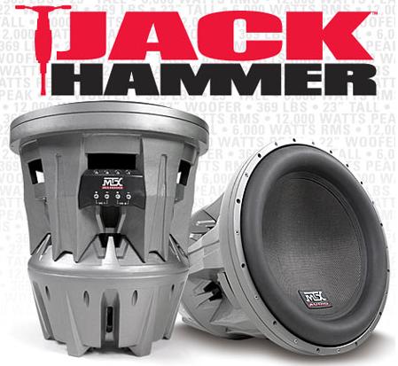

The MTX jackhammer is a real speaker that anybody can buy.
It is 22" and is rated for 6000W RMS continuously. It weighs 369 pounds.
There is a video on the web of a bunch of guys trying to install it in a car. I can't remember if the windows survived.

How much is cost about it ? What is minimum configurations require to run this mammoth ?
