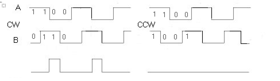

hi Al,
It sounds like an Incremental encoder rather than a Rotary encoder.
The Incremental version will give a 2 bit repeating Grey code, whereas a Rotary encoder would give an absolute code.
So for 20 detents the 2bit Grey will repeat 5 times for one full rotation.
This is not a problem but your program will have to 'calculate'/store the rotational angle.
EDIT: Al look at this link for incremental encoders.
The pattern you measure should look like this image.

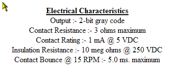

Strange readings.
Note: the contacts are only rated at 1mA, how much current is the LED passing.?
On each notch CW first a then b lights momentarily.
Is this momentary for 'a' and 'b'
On each notch CCW first b then a lights momentarily.
Is this momentary for 'b' and 'a'

Strange readings.
Hi Eric, just used a 2k2 resistor on the red LEDs, so at 5v the current should be inside 1mA, and yes to the other two questions, they light momentarily one after the other, break before make.
EDIT just put a large knob on the encoder and can turn it more delicately and they DON'T break before make and if I'm carefull I can keep them on constant by holding between detents.
Sorry was rushing before with film crew here! Very stressfull! But finished now!
Still wondering if something is iffy though, can't see how that is grey code can you?
Al
