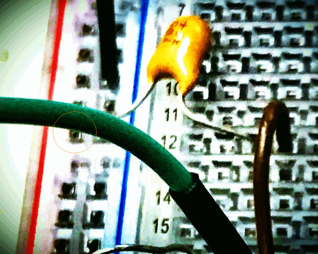

Row 11 is "-", or ground. Moving the cap lead there shorts it and, basically, removes it from the circuit. The cap's lead needs to be in either row 12 or 13.

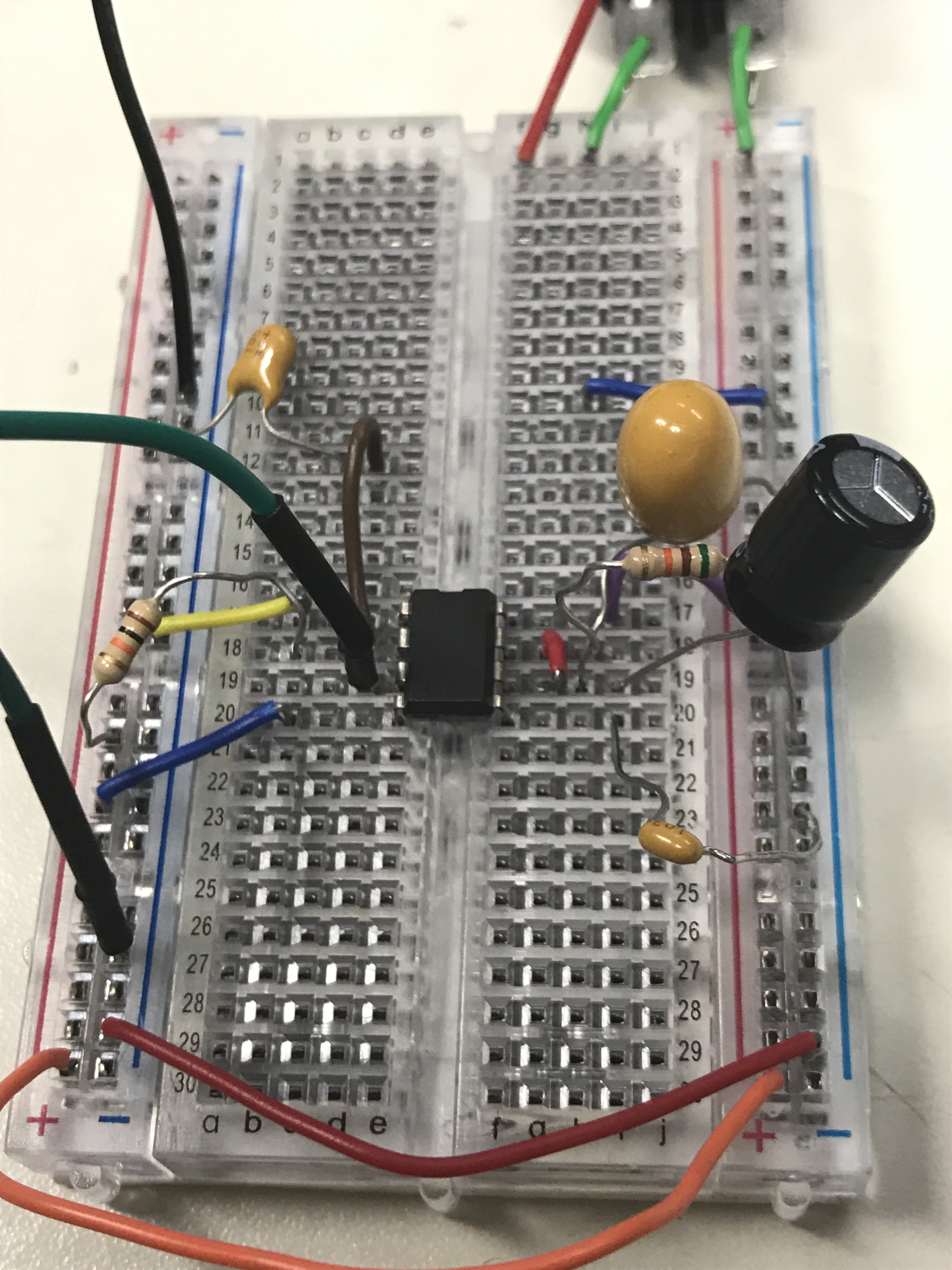

At this stage, I can't see enough of how the components, especially the timing caps which are polarized (+ and - leads), are arranged and if any of the leads are shorted together.
Best thing I can suggest is to pull ALL the parts off the board and remake the circuit in a new location on the board (the little lead grippers in the holes can weaken and not make contact properly).
I'd also suggest that as you build it, look at the schematic I gave you and, component by component, compare what you see on the board against that schematic. This exercise will help you a great deal in understanding the relationship of the real circuit and the schematic.
i believe that the negative terminals of the caps are those with the shorter leads and thus i connected those with the shorter ones to the negative sides of the board.
However, if i decide to keep the timeout timing at around 19 secs. As this is what i have now, how do i make use of the diode to keep its consistency going forward?
Do not rely on lead length for polarity.
Both caps should have a clearly printed "-" or "+" leg. The orange cap type ordinarily has the positive leg marked with a "+" sign and the round black cap types usually have the negative leg marked with a "-" sign.

What is the value of the resistor connecting pin 7 of the 555 to the +ve rail? I can't make out the band colours.
Edit:
If the timed period is less than 1 sec then the 470uF cap may not be making good contact with the breadboard sockets. Wires should enter the sockets vertically.
Edit:
51k resistor
I tried it again and it still is giving me less than 1sec time outs
A Tantalum with reverse polarity connection on the trigger pin 2?
The other on pin 5 looks to be ceramic.
If you ever connected the electrolytic capacitors with the wrong polarity then they may have lost capacitance. That could account for the short time-out. Try a different capacitor, ensuring the polarity is correct.
May i ask that for a 0.01uf capacitor, how do i see its polarity as the leads seems to be off the same length. and also on the capacitor itself , it does not show and + or - signs. It just shows 103 on one side and k1k on the other
That Tantalum is a bit off printed,
The 10 nano Tantalum, (0.01 uF) - lead is in the positive rails connection point and the Tantalum + lead is at pin 2 of the 555 timer. The pellet can fuse into a short when the part is powered with reverse polarity. If the pellet is fused internally that can make the trigger function act un predictable when operating in connection with the timer.
Or the Tantalum in reverse polarity will act as a bounce back (reject charge) when the tantalum tries to fail (pellet fusing to short). The part really can load down a circuits power supply before they make a puff. Be careful with Tantalum, their physical form can produce a volcano effect of hot gasses when they fail on a supply with plenty of current! However with a 9 V supply, the current is not known on what amount of time required to fuse the Tantalum pellet if polarity has in fact been reversed. The part would read a short if tested with a multi meter in resistance mode, or Capacitor check mode (if available) would show no charging of the capacitor at all when completely failed.
