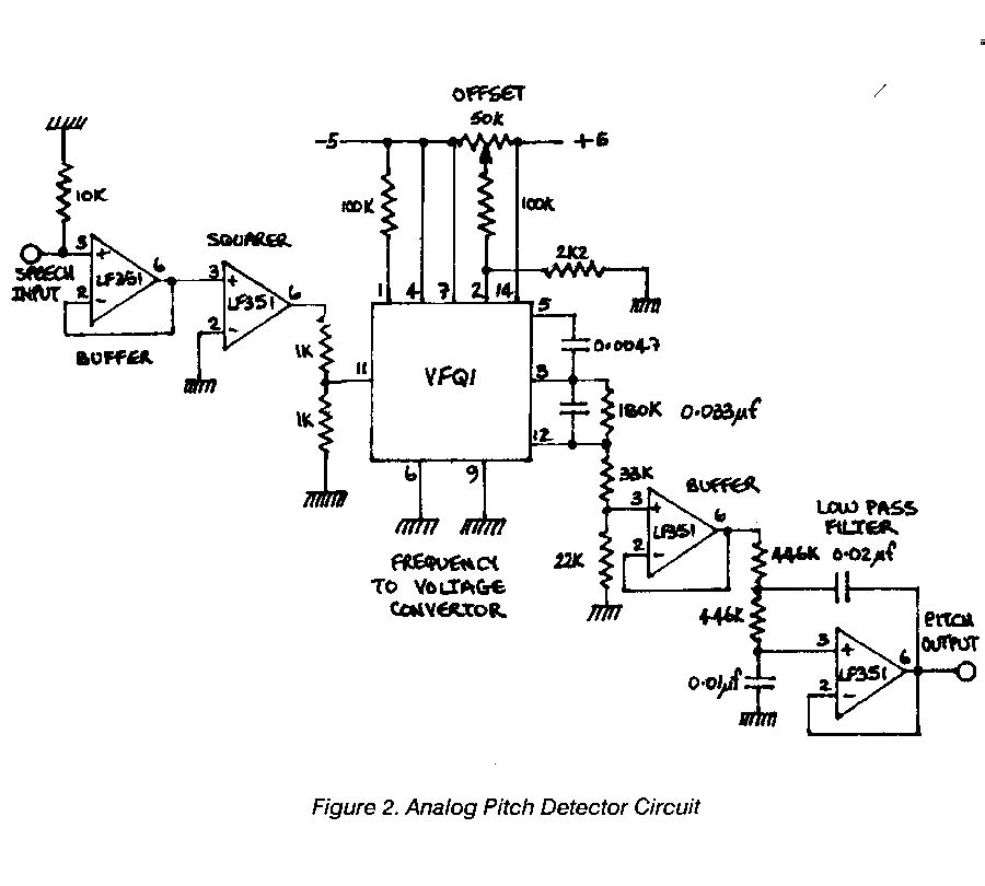

ok.... i would like to show to you one circuit that i got from a particular site.... it was a pitch detector.... but i did not understand how it works.... i understood the first part of the design.... that is the given waveform is converted to a square wave using an op-amp... but couldn understand after that.... can you explain the working of this circuit??? (we do not want to copy that idea, but if it works, we would like to do something similar to that...) i have attached the circuit for reference...
moreover when listening to FM radio, while tuning a particular station frequency, i have seen a LED glow up.... that means my circuit has latched on to the particular frequency rite?? how it works?? and is it of some relevance to my project???

Measuring the frequency of a single tone is relatively easy. Measuring the fundamental frequency of a signal that contains high-level harmonics, with an analog circuit, is extremely difficult if you have no defined bounds on the frequency and amplitude of the fundamental and the harmonics.
The scheme you are suggesting is a comb filter. If you could do this in analog fashion (e.g., using a CCD bucket brigade circuit), you would still have to deal with the fact that the output matches the input at time T, and 2T, and 3T, and ..., where T is the period of the fundamental frequency of your input.

The problem you've got is that even if you could time shift the signal, how are you hoping to compare it? You'd need to compare a distinct time-slice of both signals, not the instantaneous value of both signals because otherwise you could easily get a false trigger that the waveforms are the same when infact they are not.
To my mind, the only way to compare a "time slice" of two signals is to digitise them both and do some maths on them. ie a microcontroller or a DSP, which you have already specified as not being allowed.
I think my earlier suggestion would be a better route to investigate, but it seems I was right to question whether my idea would work for complex waveforms. You'll need to research into breaking a signal down to it's fundamental - have a look at comb filters as RonH has suggested.

I'm afraid the SAD-1024 is too long for your application. The minimum delay is about 340 usec, which means your maximum fundamental frequency would be about 3 kHz. I don't believe you have said what range of frequencies you have to detect.
