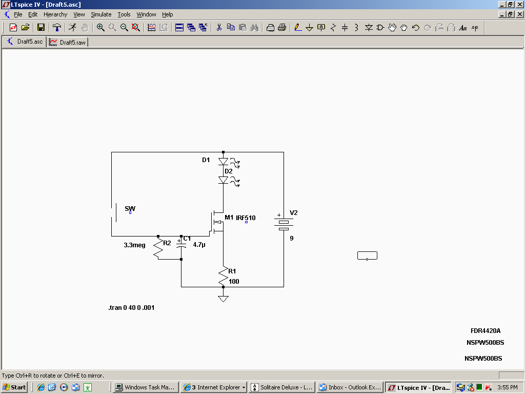

OK. I think this addresses the concerns and uses RS parts.

yes and no... move the resistor to the top side of the circuit. where it is it robs the FET of gate voltage reducing the voltage available to the LEDs by a bit more than the gate cut off voltage.
and add a zener to protect the gate from static if it does not already have one built in.

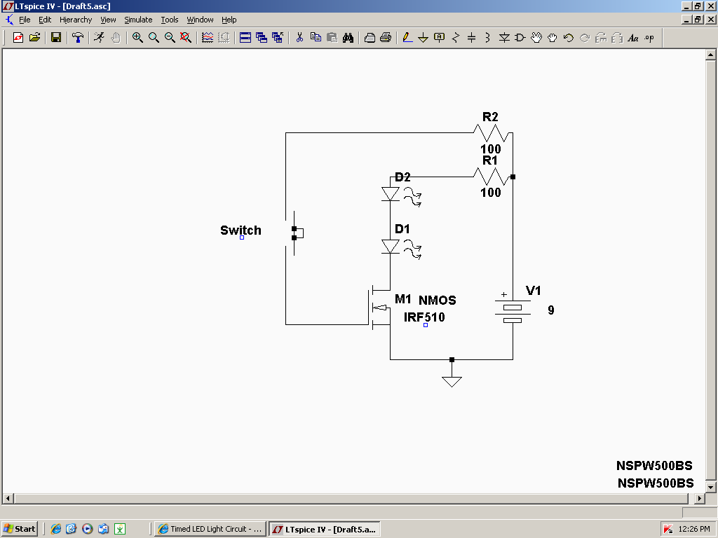

Rev 1.1.1.1.1.1
Sorry John,
Don't know where my head was when I posted that. Try this. Hope your son hasn't outgrown the idea by now.

No, he difinitely hasn't out grown it yet. I am just so thankful for everyones input and effort. You guys have spent a lot of your time to help me and have such giving hearts. May God bless you all.
We get our fun doing it. If you have trouble finding which pin goes where come back for help.
