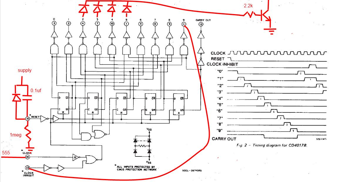

How about a 4017 counter/decoder, with a free-running 555 running at about 1 Hz.
Use the next to last output (or earlier) as the timed signal and the last output to lock out the 555 so the whole sequence does not repeat.
eg. A transistor or FET that shorts the 555 pin 7 to ground when the last output goes high, or use a resistor in line with teh clock in to the 4017 and clamp the clock in pin with the transistor/fet.
You can reset the 4017 at power on with a simple RC circuit.
https://www.ti.com/lit/ds/symlink/cd4017b.pdf
That should avoid any possible stray signals and guarantee a "clean" delayed output.
Using a 555, not shown, make a 1hz clock.
connect "9" and "clock inhibit" to stop the 4017 after 9 clocks.
Connect diodes, as shown at the top, to program when you want the out put to be on/off.

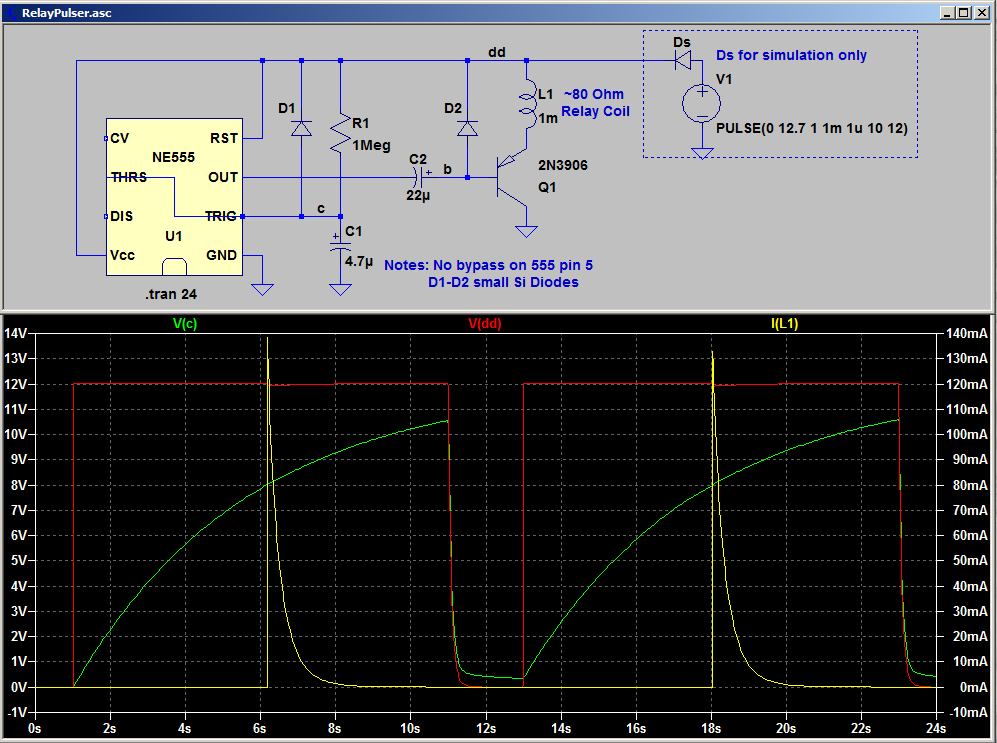

here is something that would work with a 12V automotive "sugar-cube" relay which has a coil resistance of ~80 Ohms (or higher). The 555 always wakes up triggered. The initial delay is determined by R1-C1. The ~1s relay pulse comes from C2 and the base current of Q1. V1 and Ds simulate a make-break connection to a 12.7V power supply. Ds is required for the simulation just to make sure that C1 and C2 quickly reset for a new cycle. Reset time depends on the timer being a bipolar 555, not a CMOS one.

To eliminate triggering on power-up, the RC filter is used.
A SPDT switch is used to turn off power so capacitors are immediately drained through the diodes in case you may need to retrigger the circuit again shortly after the first on-off cycle (or an interrupted cycle).
Blue trace shows left 555 which still fires fine immediately after an aborted cycle.

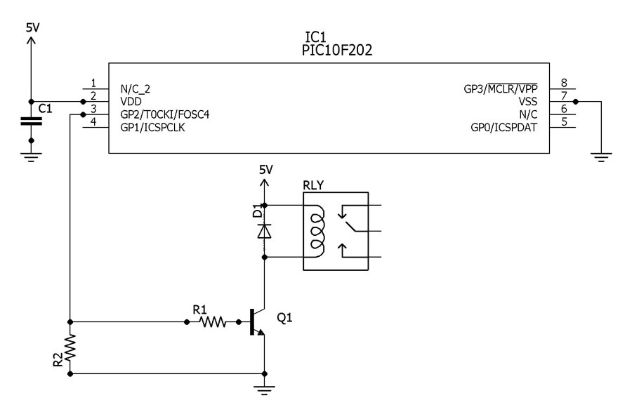

#include <xc.h>
#define _XTAL_FREQ 4000000
#pragma config MCLRE = OFF, config CP = OFF, WDTE = OFF
void main(void) {
    GPIO = 0b000000;
    TRIS=0b111101; // GPIO1 as output
    // wait 5 seconds
    __delay_ms(1000);
    __delay_ms(1000);
    __delay_ms(1000);
    __delay_ms(1000);
    __delay_ms(1000);
    GPIO = 0b000010; // Turn relay on
    // wait 1 second
    __delay_ms(1000);
    GPIO = 0b000000; // Turn relay off
    SLEEP();
    return;

And now he needs a programmer, instructions to download software, install, select microcontroller, compile your code, build a circuit so he can connect programmer to the chip, transfer said code to the PIC, then build the circuit you propose.
I'm not sure it is easier than using a few extra non-programmable parts. At the price of a PicKit, it certainly won't be cheaper.
You certainly have a point and I expected somebody to raise that issue. I think that it all depends how you look at and the specifics of the individual's current and future needs...and interests.
On the face of it, however, it is certainly on-topic with regard to the TS's request.
I need a schematic circuit for a timer. I want it to power a relay for one second about 5 to 10 seconds after power is applied to the circuit. Any suggestions? Thanks.
1. "now he needs a programmer" - Yep, and he can expect to use it over and over again. If it is a modern programmer, let's say a PICKIT-4 he can pay some $40 is it? (maybe $30 on sale?). In that case, he can use it to program pretty much any pic around...and I think it has some debugging functions. If he can settle for a PICKIT3 [clone maybe] it is under $20 **broken link removed** and there are programmers for under $10, like this one **broken link removed**.
Of course, he can build one.
2. "instructions to download software, install, select microcontroller, compile your code" Again, yes, but that does not sound particularly brutal but does involve some clicking and cutting and pasting.
3. "build a circuit so he can connect programmer to the chip" Umm no, he simply makes the connections from the programmer to the PIC with no ther components - no need to do "in-circuit programming".
4. "then build the circuit you propose." Well, yeah, but he has to build the circuit that anyone proposes.
Here are some advantages. He can change from 5 sec after power up to 15 sec or 60 sec after power up in just a few minutes and then go back to 5 sec or 2 sec and so on and so forth...using the same 10F202. The same goes for the duration of relay on time. If he doesn't know exactly what those delays need to be in the end, he has a great deal of flexibility.
He can also specify those delays with a good deal of accuracy if he needs to - e.g., 12.3 seconds is really no more difficult than 12.0 seconds.
Then he could add more to it, if he wanted to, because he has unused GPIO (including some kind of safety feature to determine if the relay is stuck?).
For expense...well a pic10f202 is what, 50 cents? If he buys a $10 programmer and makes 20 such projects...or similar ones...he is down to a buck a chip. The software can be free and includes an non-noptimized C compiler and a decent assembler and IDE (there are other options apart from Microchip).
But that is just for simple 10f202 projects - as you well know, there are a whole lot of other projects that can be done with a whole lot of different pics.
Again, I think that it depends on the individual's current and future needs (and whether they have any interest in a hardware programming approach, of course). So, that's my story and I'm sticking to it :p
