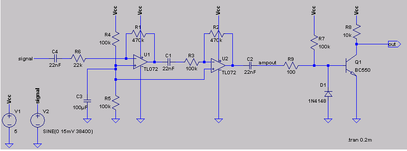

I have some questions about an ultrasonic rangefinder project I'm revisiting. That's the project; what I'm really interested in here is the dual opamp input section.
Quick background: I have a working ultrasonic rangefinder on a breadboard. The controller is an AT89C4051 (8051 compatible) which, on its output, drives a 38,400Hz square wave through two opposing pins to a 40kHz ultrasonic piezo transducer. Another (supposedly matched) transducer provides the signal for the input to a dual opamp booster which uses a BC550 transistor to pull a pin on an 8051-compatible chip low so I can read it in software. I can get readings up to around 2 meters and I can hear the blips (one blip of around 16 38.4kHz 5 times a second) on my bat detector.
I am using the input section from an old EPE article: **broken link removed**
with some changes: I've skipped the pot on the BC550 base, replaced the LM358 with a TL072, modified some resistor and capacitor values, and put a diode from the BC550 base to ground to prevent breakdown as per the Art of Electronics--all these changes have made the thing work better for me and were done incrementally, and could still be wrong! :) ).
The circuit currently working on my breadboard is shown in the first attachment. The second attachment is for those who use LTSpice--but this also works in the real world.
My problem is only my understanding of the TL072 input section. It works fine as is. I just don't know why. I mean, I know I don't get enough current to drive the BC550 into saturation without the second opamp stage, but why? And what is the easiest/prettiest way to fix it?
My questions have to do with voltage supply and current:
1) Why is the TL072 even working at all on 5V in a single-supply setup? I thought from the datasheet that it needed at least 7V. I am running it on 5V, single-supply, so 2.5V at the positive input).
2) I am using both stages of the TL072 to reamp the input to a high enough output current to drive the BC550. It works fine as posted. However, I'm wondering if there isn't a more elegant way to drive the BC500 using only one stage of the TL072, letting me use the other stage for something else, say, variable output power or a filter?
3) I have read about boosting the output current of opamps with an emitter follower in the feedback loop, but I don't quite get how to fit it in. I have done some searching but I most of the sites I find are class exercises which aren't helping much to a spare-time hobbyist like me.
Any thoughts? Why is the opamp working at all? Can I get a more elegant single-stage current drive for the input to the 8051? Any glaring errors in my work?

Hi Torben,
what is the purpose of R7 from base of bc5xx to Vcc.
you are trying to amplify the detected +ve peaks of the signal . thus the diode D1 from base to earth is OK . Perhaps you need to remove the bias for the final transistor,
After that try reducing the initial 22k in the input to say 10K, bypass the 2nd stage and try reaching the base of BC5XX

The opamps are connected as inverting amplifiers with a fairly low input impedance. I think the piezo transducer needs an amplifier with a high input impedance which would be a non-inverting amplifier.
The original circuit uses an LM358 that has very poor high frequency response but its minimum supply voltage is 3V.
The TL072 doen't meet its spec's when its supply voltage is lower than 7V.
Use an MC34071 single, MC34072 dual or MC34074 quad high speed opamp that also has a minimum supply voltage of only 3V.
In your circuit the first opamp has a voltage gain of 21.4 and the second opamp has a voltage gain of 4.7 for a total gain of 100.6.
A single MC3407x opamp can do it by itself at 40kHz.
Opamp current boost? Why?
An opamp has a max output current of about 20mA. The BC550 transistor needs an input voltage of 0.7V and an input current of only 100uA.

It's just the remains of a biasing voltage divider for the BC550; there used to be a pot going to ground and its wiper went to the BC550. It didn't appear to affect things too much so I removed it--but I'll try putting it back and see what kinds of results I get.
Ah, OK. My bat detector uses a transistor preamp instead of an opamp, so maybe I'll give a version of that a shot too. But I'll definitely try the non-inverting configuration and see what I can get out of it.
Makes sense. Might explain the apparently quite low current it's able to deliver. I was surprised to see it working at all, but working out of spec makes sense.

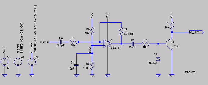

OK, I have looked up the MC3407x and it looks like they're discontinued. A suggested replacement is the TLE214x, which seems to fit the bill, except it doesn't have FET inputs so I might need to go to the non-inverting amp after all (not sure about this yet).
However, I got a spice model for the TLE2141 and with some changes in my circuit it works nicely--in my simulation. Haven't ordered any yet. The TL072, which does work at 5V when using both stages, totally fails when using one stage at 5V. The TLE2141 does the trick.
Some other things I would like to clarify:
1) I think that the voltage on the base of Q1 does not suffer limiting from D1 because of the base-emitter diode action of Q1. Is this true?
2) I think I'm OK pulling the bias on the positive input of U1 so hard to Vcc because I *want* to slam the output from 5V to 0V when receiving. Is this reasonable?
Hoping to order some TLE2141s soon if this is a reasonable circuit.
Thoughts? Thanks!
Torben
You have biased the input at 4.5V, when the input common mode range extends to only 3V. You should probably set the input bias voltage at about 2V.
You have a highpass filter (220pF, 10k) on the input at 72kHz. Your input capacitor should be at least 1.6nF, which would set the corner at 10kHz.
EDIT: I see why you picked the values you did. In the simulation, it works with them, and it doesn't with the values I recommended.:mad:
I'm not sure I would trust the spice model. You are clearly exceeding the common mode range by a large amount. You can probably get the circuit to work, but you should probably be prepared to juggle component values when you build hardware.
