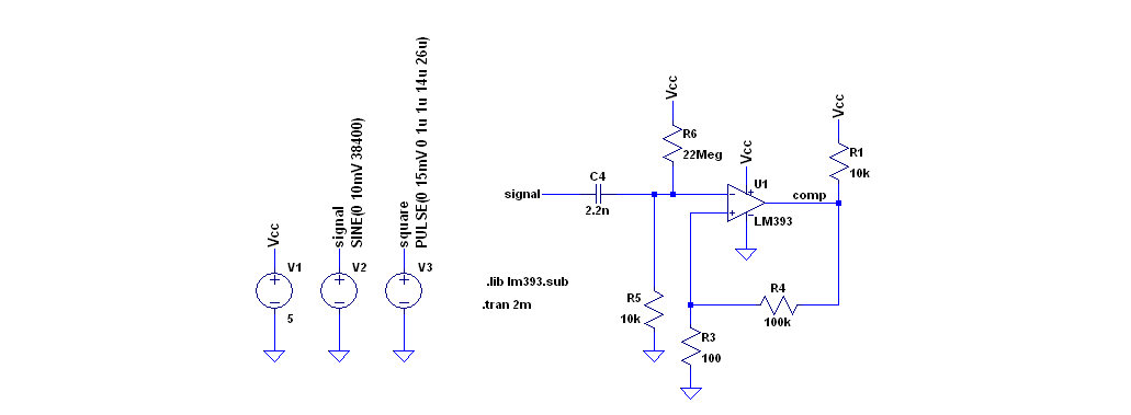

Torben, have you considered just using a comparator? If you don't use the other comparator section, you need to tie one input only to GND.
Below is the model for LM393, if you don't have it. Save it as LM393.sub in the SUB folder under LIB.
  • ultrasonic lm393.asc
Well dang. That looks like it might do the trick quite nicely. Thanks!
