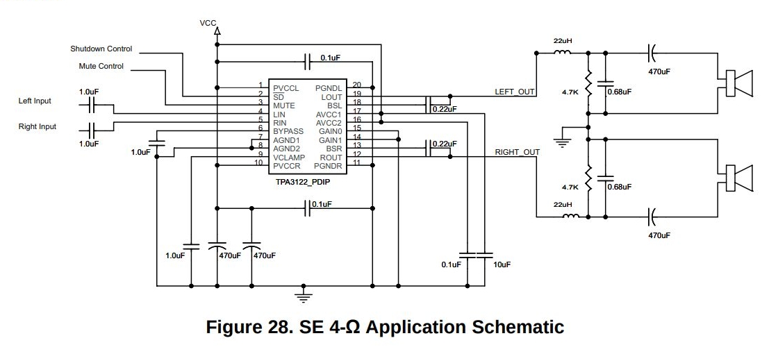

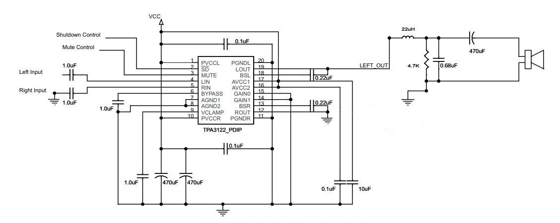

I'm looking at building a TPA3122 circuit for use as the power amp section of a small 12v battery guitar amp. It would give me 5w at 4ohm which is perfect and at 90% efficiency. I've always wanted to do a class D and this chip seems like the right one. The one issue is that I only need one channel. Rather than build out both channels just to shunt one, can I remove the output caps, resistor, and filter from the right channel and then shunt to ground? I've attached an image of the original circuit from the datasheet as well as my proposed version.
Of note, I had thought about going BTL, but the biggest concern is that it would require even more parts because I would need to use a SE to differential converter in front. That and the SE mode provides the power I need at the voltage I can provide (12-14v.)
Thanks for any insight!

You certainly MUST NOT short the output to ground like that! :nailbiting:
It would make a lot more sense to bridge it, and get 8W in to 8 ohms - the difference would be well worth it.
As for 'more parts', you're over complicating it with " SE to differential converter in front" - all you need is a simple inverter on one input, just a single opamp in inverting mode - and you will of course save the 470uF coupling capacitor as well (which seems a bit low anyway).

Nigel, that's what I get for posting this in a hurry. It was suppose to send the right channel into an 8ohm resistor.
No need, and no use for it - simply ground the input (before the capacitor! - as shown on your diagram), and forget about it.

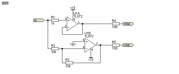

I'm curious if I could trim some of the capacitors out without losing stability. Rod Elliot shows a very similar circuit to mine, but with no capacitors at all: https://sound-au.com/project51.htm (figure 1 from his site is attached). Also Rod's circuit uses 100 ohm resistors at the tail of each leg of the differential output, is this a good idea?
I always thought you needed caps to decouple between sections etc, maybe not? Thoughts on this?

The capacitors are there to block any DC voltages - if there aren't any (and can't possibly EVER be any), then you don't need them.Very often they are included because you don't know what's going to be connected to it (either IN or OUT). 'Mostly', anything properly designed will include blocking capacitors on the inputs and outputs, so you don't 'need' to - but if you think you don't 'need' to, perhaps they did as well?.
Inside your complete circuit is fine, as you're 100% in control - but external connections should be DC blocked.
The 100 ohm resistors are for if the circuit is directly feeding a long coaxial (screened) cable, and prevent instability. In your case, presumably the splitter/inverter is directly next to the power amp?.
Looks like the only cap that might be removable would be the 5pF one on the inverting section which was for "rolloff of frequencies above the audible range". Realistically, does the 5pF really do anything important?

While a tiny value like 5pF looks like it does nothing, the crazy high values of the resistors means the HF rolloff is 30KHz.
Where did the 1M resistors come from? - notice the other example uses 33K - which makes a lot more sense.
If you made the resistors 100K, you could use a 50pF capacitor, or make them 10K and use a 500pF.
You could connect R1 directly to the output of the first opamp, getting rid of the 0.1uF, leaving the 10uF to fed the direct output.

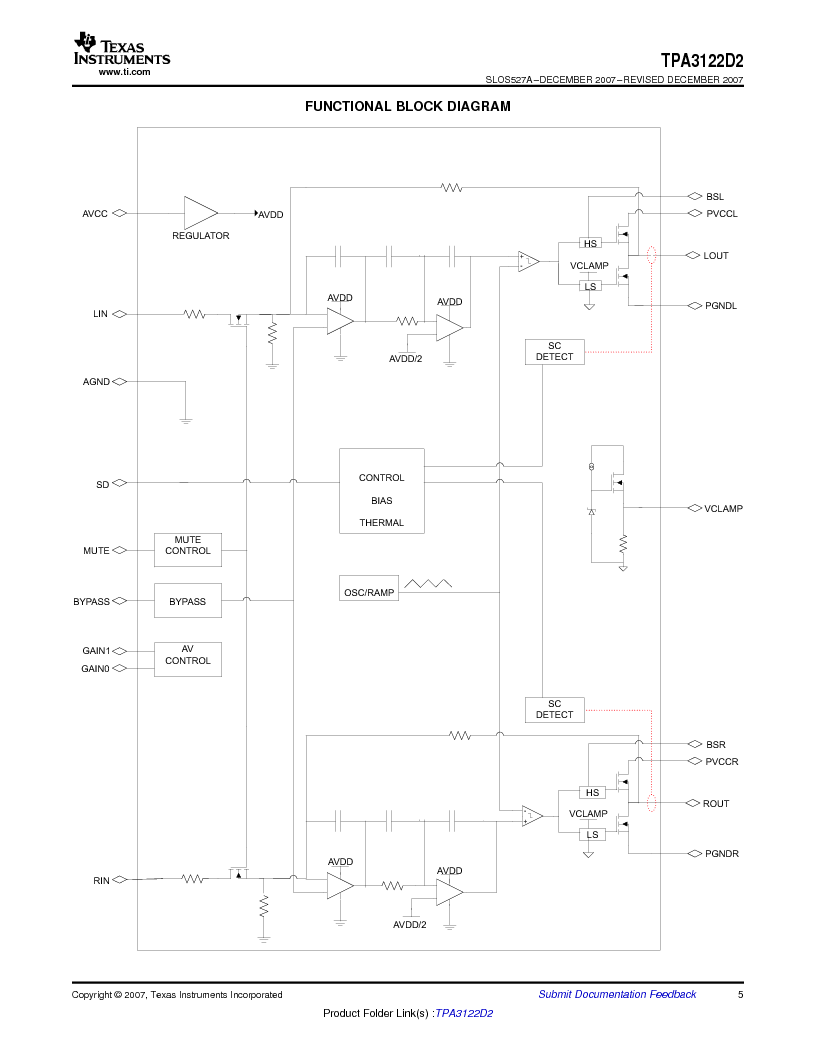

I've been looking at the functional block diagram and pinout descriptions for the TPA3122D2N. I'm thinking that if I disconnected V+ to the right channel, I could completely remove all pieces of it (input capacitor, bootstrap cap, output resistor/caps/inductor) and not even need to ground in the input. No power, no signal, no problem?
Attached is the block diagram. I'm talking about not sending voltage to PVCCR and not installing the bootstrap capacitor between BSR and ROUT. There is a note in the descriptions of each pin that PVCCR is "Power supply for right channel H-bridge, not connected to PVCCL or AVCC.".

Also, any thoughts on disconnecting power to the right channel and leaving it floating? I'm thinking that it would mean I could omit a resistor on the right input since it wouldn't have power anyway. From the block diagram it seems to me that the left and right channels are separate so it should be ok.

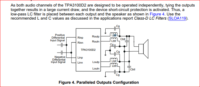

Can the TPA3122 be used this way? (from the TPA3100 datasheet)
I don't believe so. Regardless, my goal here is efficiency at low wattage (0.5w to 2w or so). Running in SE mode gives me really high efficiency at 4ohm (65% - 80%). It can be run in BTL mode and be bridged, but at the wattage I'm looking at it is yielding 40% - 70% efficiency. Given that the majority of the time I am playing around 1w the SE mode is way more efficient (about 76% vs 55%). If PBTL was possible, it would probably be at about the same efficiency rating as BTL.
