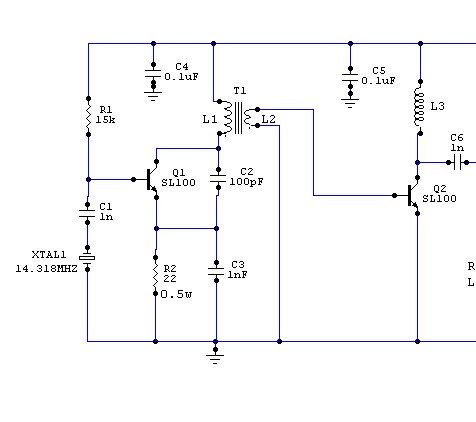

Have a look at the first two stages of an HF transmitter below which are coupled by Transformer Coupling

There has to be enough signal at L2 to turn on Q2. If L2 has too many turns, the loading on L1 might kill the oscillator. Otherwise, the turns ratio is not critical. I think 1:1 or 2:1 would work. If it were me, I would put a coupling cap and resistor to ground on the base of Q2.

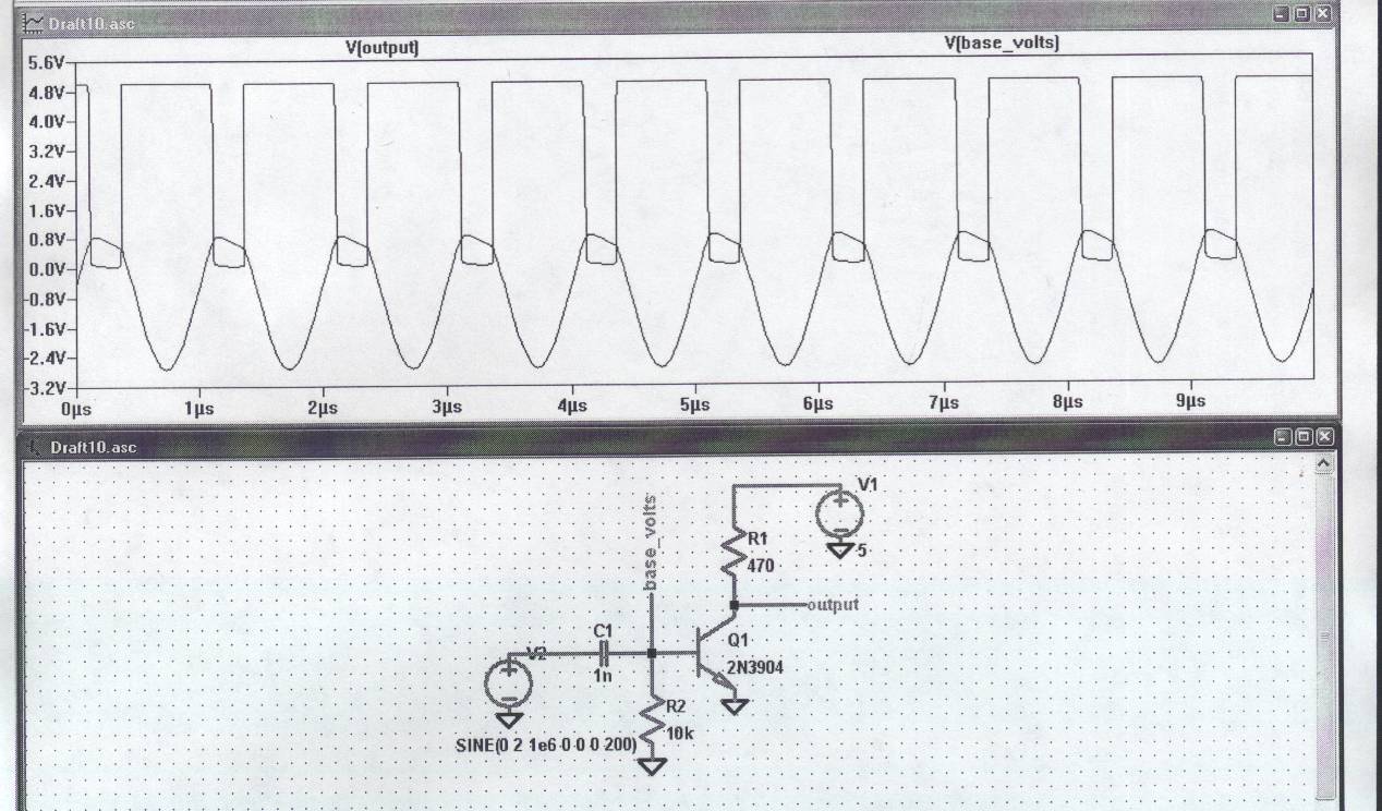

The resistor controls the drive level to Q2. If the resistor is too large, Q2 output will have a small signal. You would have to experiment to see what value is best. Driving Q2 hard into saturation would not be good.
The way it works, is the coupling cap charges up when the base-emitter conducts, so the next alternation only drives the base enough to compensate for the charge lost thru the resistor.

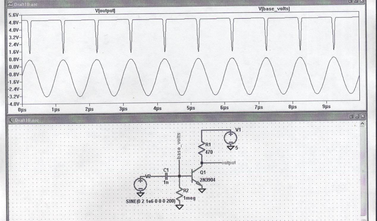

The output is smaller with a large base resistor because the coupling cap charges up, putting a negative bias on the base. With 1 meg base resistor in the simulation, the base voltage barely gets up to 0.8 volts; but when the base resistor is 10K, the cap discharges more and there is a larger slug of base current and larger output.
