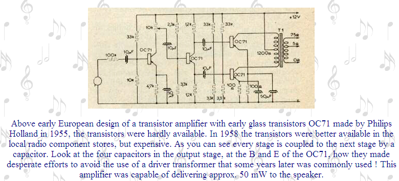

A 1k/8R output transformer was used in a radio made in 1955. It might not be available today.
Last I checked it's still a popular transformer. I've seen many of them on electronics part sites and at stores like RadioShack.
I think old vacuum tube amplifiers used a power 1k:8r audio transformer if you can find one. It works the same but is bigger and heavier.

I saw a youtube video using this circuit from 555-timer and saw a same blue and small audio transformer in our local shops with 1k ohms primary impedance and 8 ohms secondary impedance. But my problem is, does it matter if it is an audio INPUT transformer rather than a audio OUTPUT transformer? Is it okay to use this audio INPUT transformer? What's available is the audio INPUT transformer. I've read the entire thread and know from you guys that whats important is the turn ratio of the audio transformer, the higher the difference the higher the voltage it outputs to the voltage doubler. I wish you could enlighten me with this as I am still a student :D
does the audio transformer need to be an output one? We found the same color, same size, same everything audio transformer with 1k ohm primary impedance and 8 ohm secondary impedance but it is a Audio INPUT transformer. Does it matter? or does the turn ratio is the only variable that is important?
Since your shopkeeper knows nothing about electronics, he wrongly calls the audio output transformer an input transformer. Maybe the transformer manufacturer also knows nothing about electronics?
A loudspeaker is 8 ohms and was used at the output of an amplifier. A microphone is either 600 ohms or a few k ohms and was used at the input of an amplifier.
Transformers were used in amplifiers 50 or 60 years ago. Here is the schematic of a transistor amplifier made 59 years ago with an output transformer that drives a 7.5 ohm or a 5 ohm loudspeaker:

That 42TL013 is an Audio OUTPUT Transformer.
I Don't know if your Shop keeper was telling you the Wrong Info, But yes there CAN be a Difference between an Input and Output Transformer.
Even if the Sizeand Impedance is the same, There can be WIRE SIZE Differences.
And that results in Power Capability Differences.
And that 42TL013, Output transformer is still available.
But that circuit is Not worth building.
