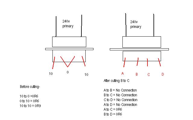

Further on the transformers outputs!
Hi again,
After opening the transformers casing I can see that the center tap seems to dissappear into the windings at BOTH ends! So in theory I may be able to cur it at the center and have two separate windings.
If I can would that mean I could parallel them up and actually get the extra current?
Regards.....Al
Hi again,
Regards.....Al

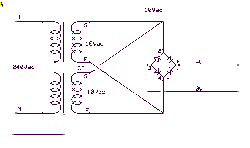

Thats what I was hoping you find.:)
Carefully cut the junction of the two wires at their tips. Leave the wires as long as possible.
Use an ohm meter to check their resistances, they will have low resistance, almost equal.
Also check with meter, after the cut, that both windings are not interconnected to each other, so that you have two isolated windings,,,lets know,
EDIT:
IF the windings pass this test, then plug in the transformer to the mains supply, measure the 'ac' voltage of the two windings
in order to ensure that they are the same voltage.
IF they are the same, connect the windings as shown here.
Hi Eric,
Here are the results, what do you think?
Edit:- they are both 11.1v exactly.
Regards.......Al
Hi again Eric,
On my transformer the two center pins seem to be crossed inside the windings so should I connect A to B and C to D to get the configuration in your drawing?
And by the way what do F and S stand for on the drawing?
Edit:-
Yes thats right, its working now so thanks to all! :)
Thanks...........Al
