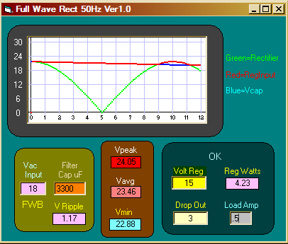

The peak voltage across C1 is 18√2 minus any rectifier losses, let's say 24.5V at full load.
Q2 and Q4 are configured as a Darlington pair, with a saturation voltage of about 2V at full load so in order for the output voltage to be 24V the input needs to be at least 26V.
It won't work up to 24V, need I say any more?
hi hero,
As you say not enough overhead from the bridge to give a +24Vout.
Ignore the image section regarding the regulator data.

The voltage on the input is probably going to be higher than 24.5V - and in any case, it's NOT a regulated supply, so if it drops a bit under full load at full voltage, it doesn't matter. Suggesting you move from an 18V to a 36V transformer is ludicrous, will blow the capacitors up, and massively overheat the regulator.
While you were 'looking carefully' did you not read the discussion of the transformer?.
Funny, I thought it was supposed to be a regulated supply. Even if the voltage is higher than 24.5V, say 30V off load, it certainly will drop below 26V when a load is connected and the ripple valley will be even lower, probably about 18V.
I didn't suggest that.
I'd suggest using a 30V untapped transformer with a bridge rectifier and 50V capacitors.
I admit, I didn't read it before but now I have, I can say it's inadequate because it doesn't discuss peak voltage, dropout, ripple, current rating, and filter capacitor sizing; all important things to consider when selecting a transformer and filter capacitors.
