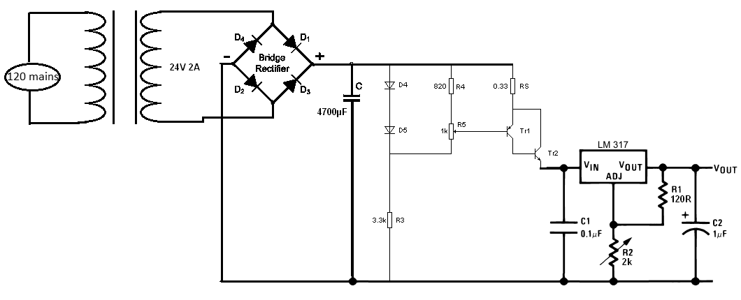

The LM317 will nearly do that.
The maximum current rating is 1.5A but I've had no problems drawing 2A for extended periods of time. the datasheet says the the current limit varies between 1.5A and 3.4A, 2.2A is typical but don't bet on it. The current can also be boosted by adding another transistor or more.
The current limit is fixed between 1.5A and 2.2A but can be made adjustable by adding a couple transistors.
The minimum voltage setting is 1.25V but it can be reduced to zero using a band gap reference or an op-amp.

Operating down to 0V is not important but I would like it to be close to it like 1.5V
I do want adjustable current limiting
1.5A is fine it does not have to be 2A
And it does not have to go all the way to 20V but I would like at least 12V

That makes things much easier.
Connect the following two circuits together:
Change the following values:
R1 = 120R
R2 = 2k
Mount the LM317 on a large heatshink, such as one from an old pentium 3.
C = 4700µF, 50V
D1 to D4 = 1N4001 or a 2A bridge rectifier module.
Replace the load with the previous circuit, + to - and the earth/ground symbol to -.
Replace the sinewave generator (left of the bridge rectifier) with a 50VA (or greater) 120V to 24VAC mains transformer.

You should include a mains fuse in series with the transformer's primary, 500mA slow blow or 1A will do.
If you put the circuit in a metal box you must connect the metal to the earth/ground conductor. All mains connections should be covered with a layer of heatshrink.

So is this basically what I need to do before the adjustable current limiting part is added? and i didnt change the companent values yet (I allready made the pic before I saw that you were working on a different schematic)
Yes that's what you need to do.
I'll post the current limiter when I get time.
Here you go, it's not a perfect solution but it'll work.

Are d4 and d5 in the current limiting part just regular 1n400x diodes?
I worked on the schematic for a lil bit to clean it up and label all components.. is this correct as the final version?

Yes the diodes can be 1N4001 or 1N4148 it's not critical, any silicon diodes will do.
Tr1 can be any low power transistor which can handel at least 40V at 200mA e.g. BC327 or 2N2907.
Tr2 needs to be a power transistor e.g. BD437 or TIP41, and should be on a heat sink.

oh yeah one last question.. C1 (in my schematic) can that capacitor be aluminum electrolytic? and is it actually supposed to me 4700uF, or 4700pF?
I'm not meaning to be difficult but what do you think?
Try having a go at answering this for yourself and I'll confirm your answer.
