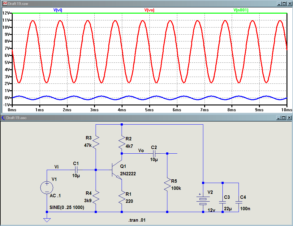

iv read up on it but i still can find anywhere that say how i would go about picking the right component values for a class a signal transistor pre amp for my guitar.
are these all the components i need?
how do i choose these components? i have read about how they work and i know what they do and exactly how the transistor works but i don't know how to pick the values?
i know that the biasing resistors have to put a biasing voltage of half the input signal+the voltage drop of the transistor (0.6 usually). but what about the base to emitter current?

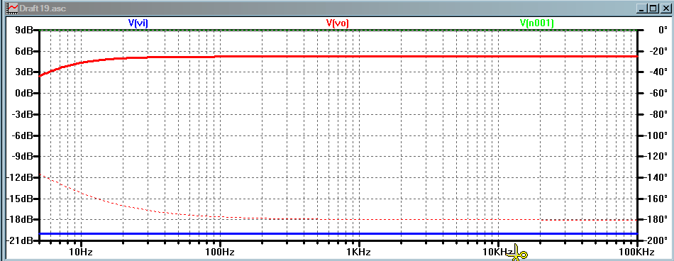

hi cracken,
Look at this LTS showing a simple single stage 2N2222, Class 'A' transistor pre-amplifier.

View attachment 39333View attachment 39334
what i was trying to get at in my question was how do you choose the values of the resistors. i know the formula to work out the input output capacitor and it pretty much the same for all amps anyway. but R1 R2 R3 R4 i have no idea and the annoying thing is iv read load of shuff on it and i still cant work it out!

This is the actual LTS *.asc file, open and run it with your LTspice, see if it runs OK.
Are you asking what the function of C3 and C4 is in an actual circuit.?

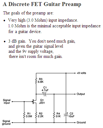

A transistor cannot provide the high input resistance needed by a guitar preamp and the gain of the circuits that are shown is too high.
The opamp preamp that was shown has an input resistance of 1M ohm and a gain that is high enough to produce very high distortion in the diodes.
Here is a guitar preamp that uses a Jfet for a high 3M input resistance and a gain that is less than 2.

The input impedance of your transistor circuit is so low that it is like a dead short to a guitar pickup. Its very low impedance also changes the sound of the pickup.

Now different people have different ideas but I'm a big believer in the theory that the current through the emitter should be between 5 - 10 times that of the base current. Let's pick a ratio of about midway, 7 i.e 0.7 mA for emitter current.

When using a resistive divider to bias the base of the transistor you need to have sufficient current flowing thru the divider in order to avoid the small changes of current into the base from changing the bias point voltage.
Its common to choose between 5 and 10 times the required base current to flow thru the biasing resistor divider.
Its not guess work, its working with an acceptable range of divider currents.

The transistor has a current gain of about 200 so its input current is almost nothing. The voltage divider resistors that feed current to the transistor's base has a current that is 1/10th to 1/20th the emitter current.
