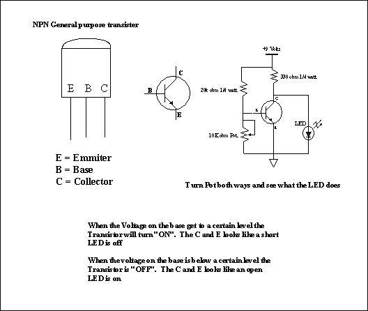

best way to to understand is to hook it up.
