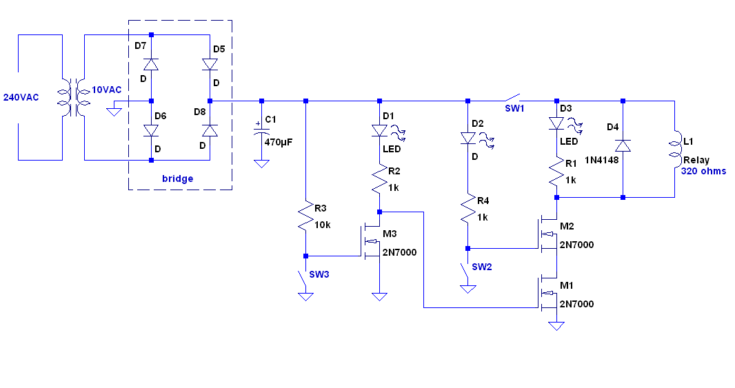

Transistor as a switch
OK, here's about the simplest circuit I could come up with.
Thanks for that Roff your a star:D
Pics are easy, I find them alot easier to work with and I had made a circuit and program to do what I wanted to do but I didnt want to use it as I thought it was about time learned how to use transistors:D
