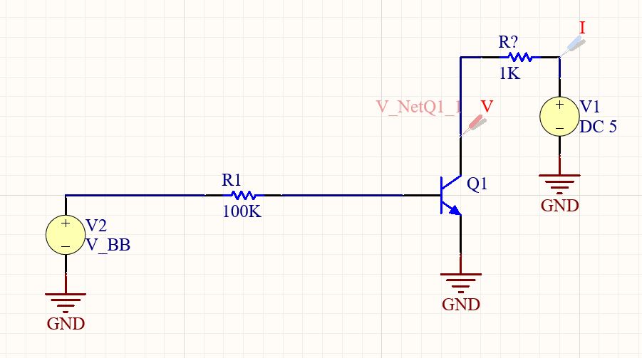

Have I plotted the correct output characteristics of the CE Transistor? How can I improve if I want to add IB Values at end of each line? I am using Altium Designer 22.

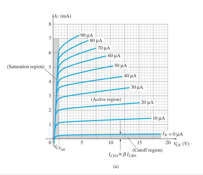

The reference image is given of how I want to plot.

Every transistor part number has a datasheet showing wide ranges of specs (current gain, base-emitter voltage).
You show characteristics of only one rare transistor and you must buy hundreds or thousands of transistors and test them all to find one that matches your graphs.
