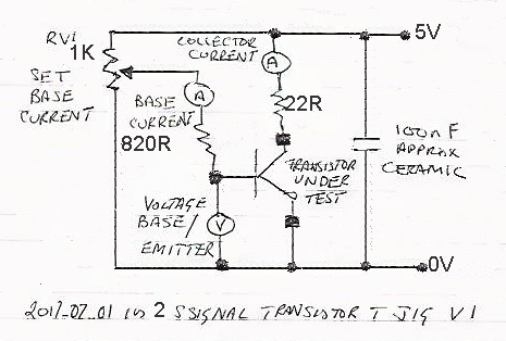

Hi again Nethra,
below is a sketch showing a suitable small signal NPN BJT DC test jig. Just reverse the power lines to test a PNP BJT.
A nice touch would be to make RV1 a ten-turn potentiometer.
spec
Hi Spec,
Isn't your transistor testy jig designed for a power transistor on a heatsink?
With a 12V supply the poor little transistor will saturate with a collector current approaching 1.2A! If the trimpot is turned down so the transistor is linear then it will melt when it dissipates 3.6W!

Hi Spec,
Thanks AG,
That's what happens when I do not pay attention.:banghead:
spec
(schematic of post #4 now updated)

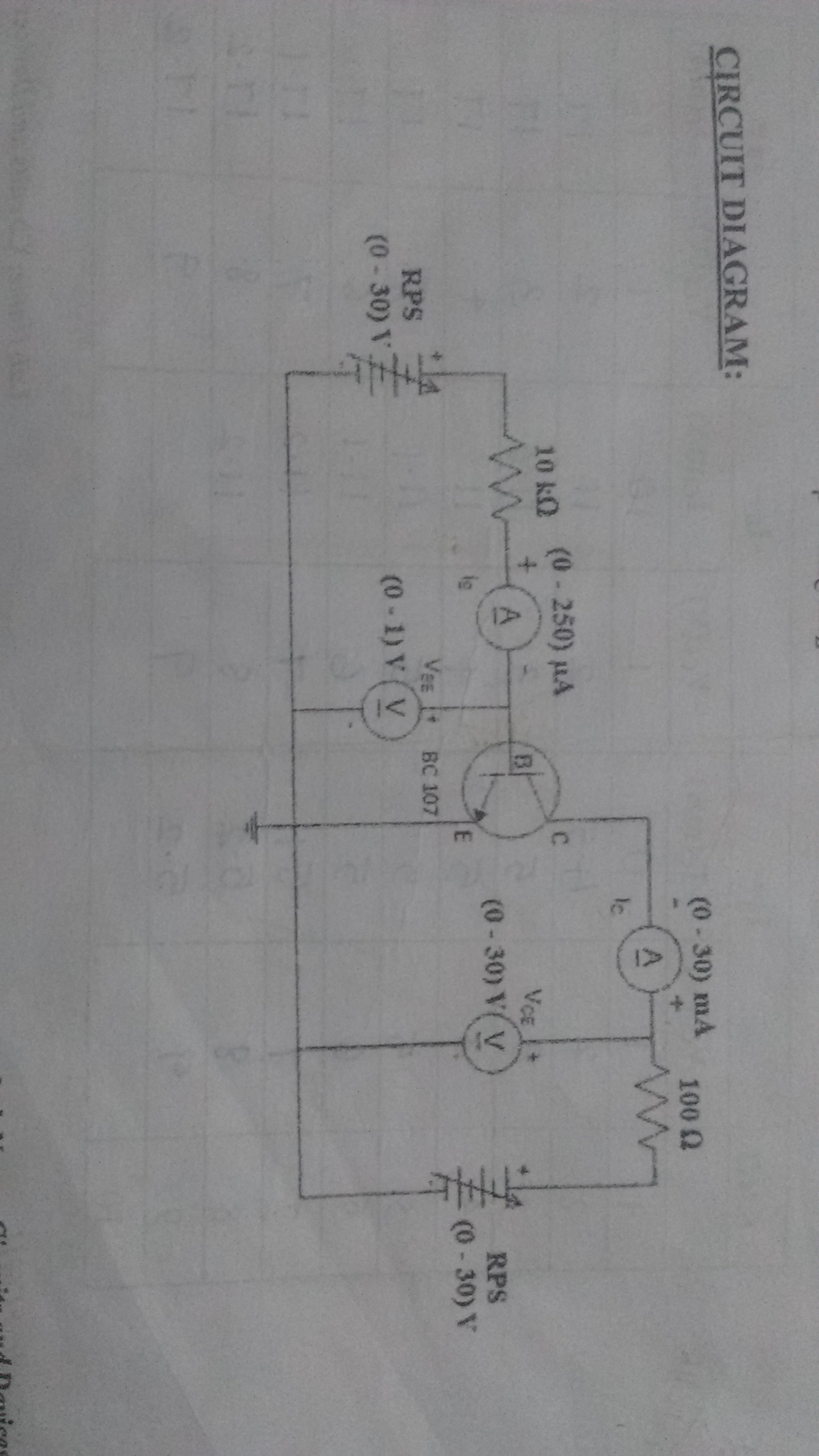

Thank you all.. but then I am sure that the transistor is working fine and the emitter and collector are placed correctly.
I am using a bread board circuit. The emitter is grounded directly.
Please show your circuit.
How are you getting your results. (SPICE or bread board)
Do you have a emitter resistor to ground.
Base current=? Emitter current=? Collector current=?
I think you burned out the poor little 50 years old transistor and now its base-emitter is just a piece of carbon resistance.
The datasheet for the old BC107 says its maximum allowed continuous collector current is only 100mA but with your 100 ohm collector resistor then with a 30V supply the maximum current is 295mA.
The datasheet has a graph showing that with a collector current of 10μA the typical base-emitter voltage is 510mV, with 100μA the voltage is 545mV, with 1mA the voltage is 0.6V, with 10mA the voltage is 675mA and with 100mA the voltage is 760mA which are non-linear like a silicon diode.
Of course the base-emitter voltage drops as the transistor heats up.
