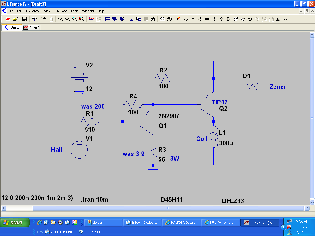

TX Ign.
It's not a super good circuit, but yes you could change a couple of resistors and make it work on 12 volts. See attached schematic.
ronv,
Thanks for the circuit design.. But I have to admit that I am TOTALLY dumb when it comes to reading those things. Wire diagrams I can follow because they are a little more traceable as in you can see what comes from what point and leads to the next point and follow the flow of current.. I know you spent a good bit of time working it out for me. Is there a way you could make a components/parts list for me?
I think I should also get a bread board circuit testes kit like from radio shack or off ebay.. Maybe then I can understand the flow of things.
You mentioned that it is not a super good circuit.. is there some sort falls I need to pay attention to?

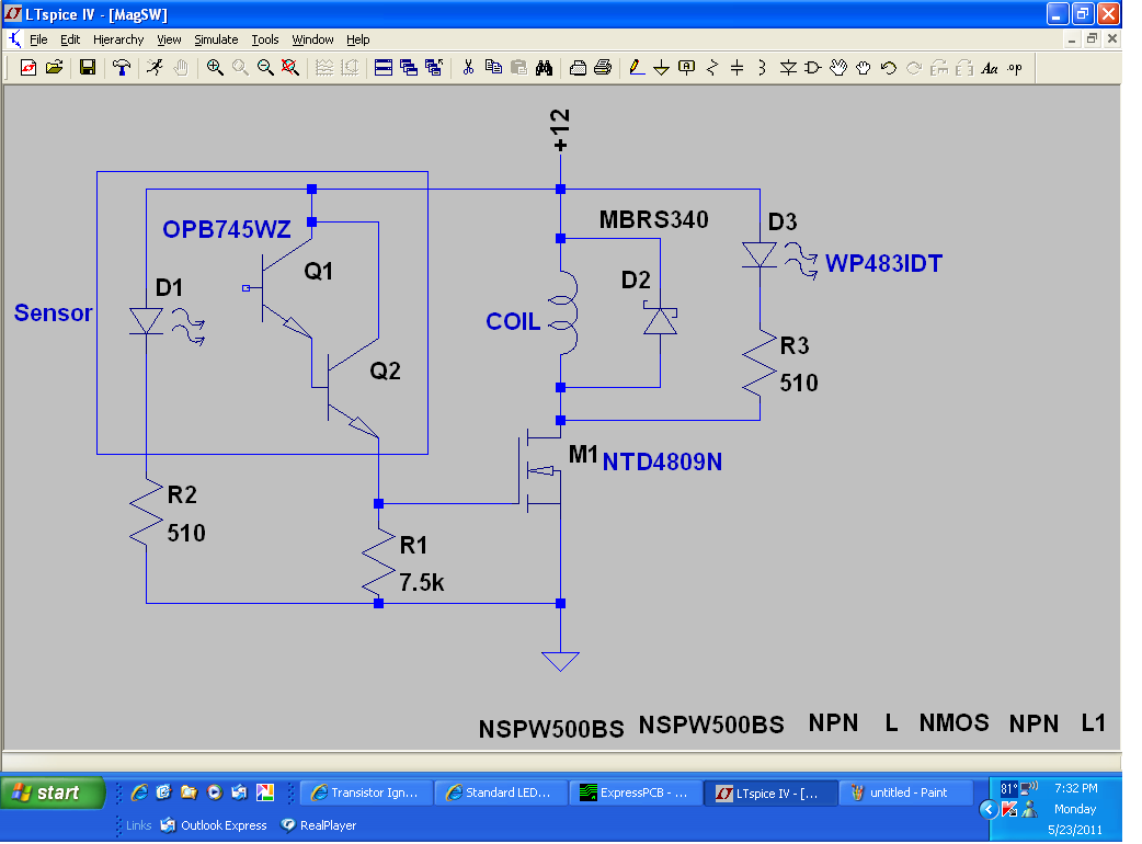

Now because I am not 100% sure how the electromagnet coil would actually work I ordered a 12 volt electromagnet coil that can hold/lift 40kg (88.2 lbs) and it had a diameter of 49mm (1.93 inches) just a little larger than the opening in the housing for the cylinder but smaller than the bolt circle that holds the cylinder sleeve in place.

ronv,
I'm actually thinking that going with the optical switch may be the best bet for what we are working on. I say that because we may have some problems with the magnets and the steel flywheel and trying to dial in the timing for the hall switch. Sorry if that complicates the circuit your helping me with.
Actually I think the optical sensor would be the best. Do you have a link to the coil? That would tell us how much current is needed to drive it. I think we can come up with a very simple circuit to drive it in one direction. More complicated to make it push and pull.
I can't find a site for the electromagnet coil as I got it off eBay. I did alot of searching for one the size I needed and it was the closest one I could find. I also took a quick look on eBay for the optical sensor to get an idea and maybe some part numbers. They had a few that I would spring for. I might even be able to pick something up at the local radio shack.. I will have to look this week.

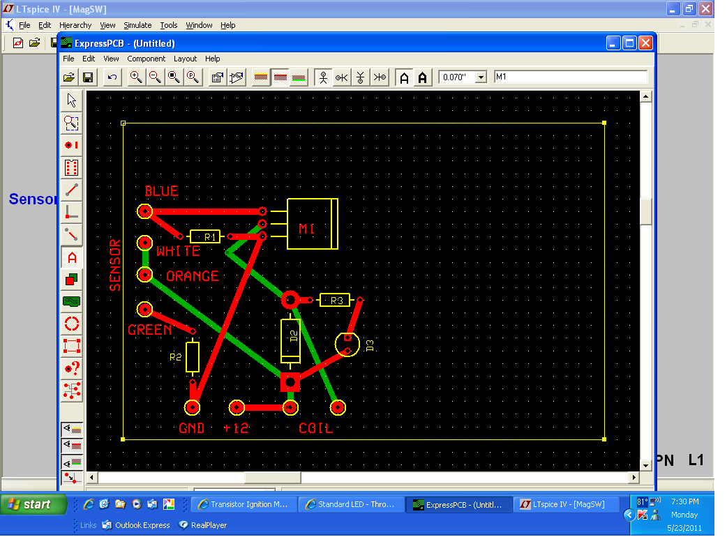

Mag Driver
Here is a schematic of the circuit. You can get the parts at mouser.com. Let me know if you would like a pictorial of how to hook the parts together.
Thanks for the schematic of the circuit.. If it isn't too much trouble, then yes I'd like a pictorial of how to hook the parts together.
One question.. Is this circuit you made for me based off the circuit board and parts used by the JEH circuit board or do I need to make a new board and get all new parts?
