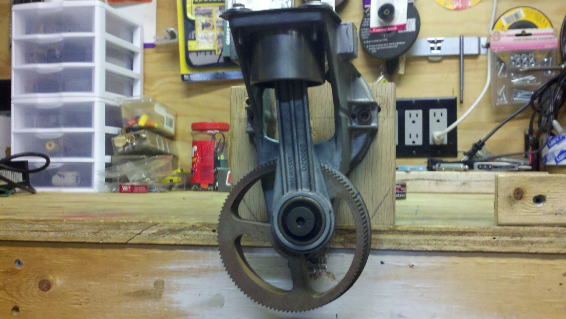

I have taken a host of pictures so that you can get an idea of what my son and I are working on.

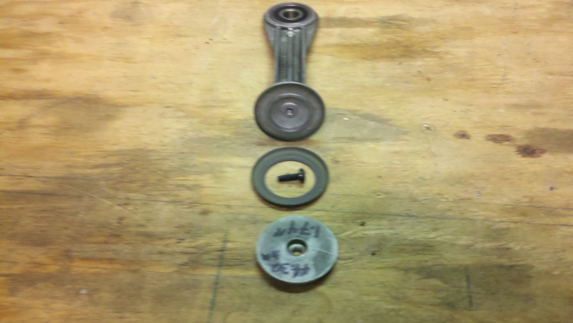

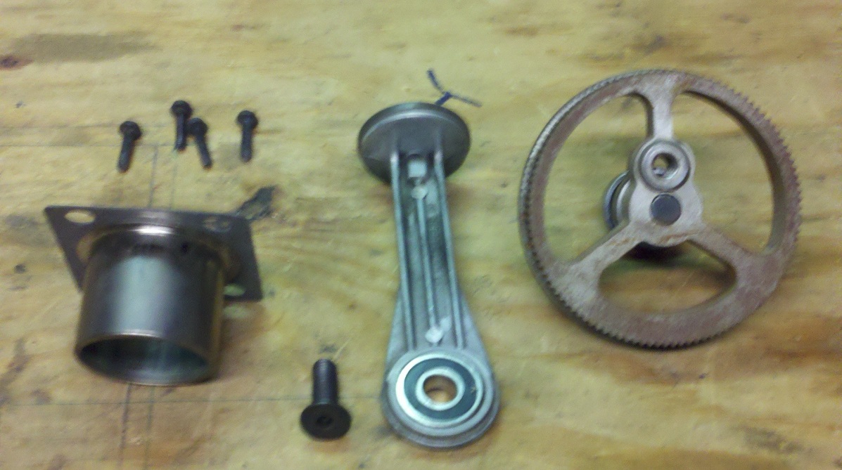

Here is the first set of 3 pictures That shows the moving parts:
Sorry the pictures are the greatest quality, I took them using my Droid Cell phone.

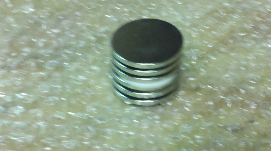

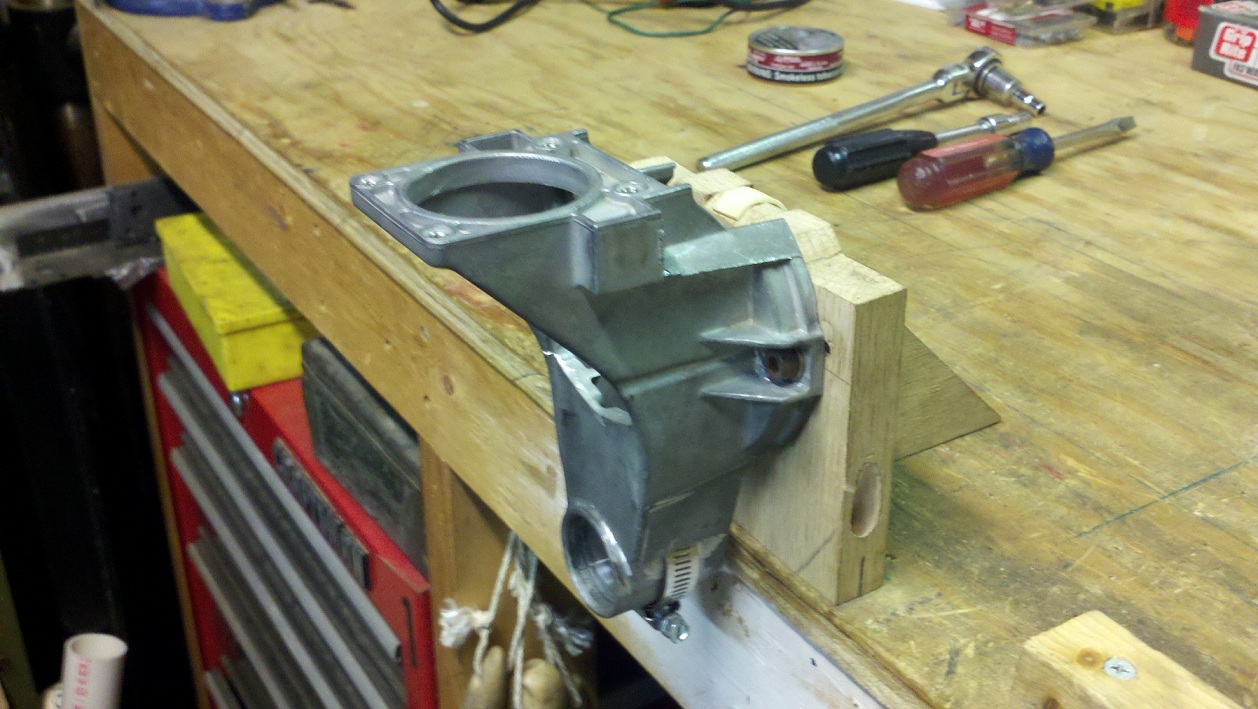

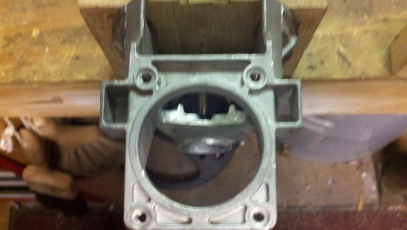

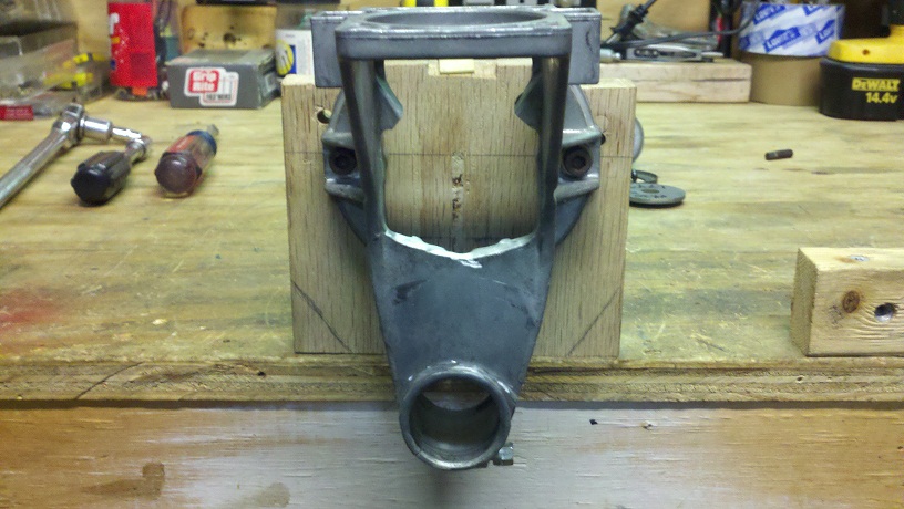

These pictures show the electric compressor chassis.
In the first picture (front view) you'll notice a hole in the bottom, that is where the flywheel and support bearings sit. The larger hole in the middle is where I had to cut out the burnt up electric motor and electric motor bearing mount.
The follow on pictures are just taken different angles.

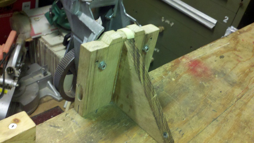

These last pictures show the moving parts all assembled. It is a super simple assembly. I made a wooden bracket so I would have something to mount the chassis to and a way to mount it on the bench.

The whole assembly turns freely once you have everything aligned. All the bearings are sealed so no worries on slinging oil on the electrical parts. Yes I replied to your PM.. I will have to get a good picture of the flywheel from the side so you can really see the profile, then I'll explain my idea for using a slitted optical sensor.. I might need some assistance picking that out.. Little steps first! LOL Besides my electromagnet still hasn't made it here from China yet!

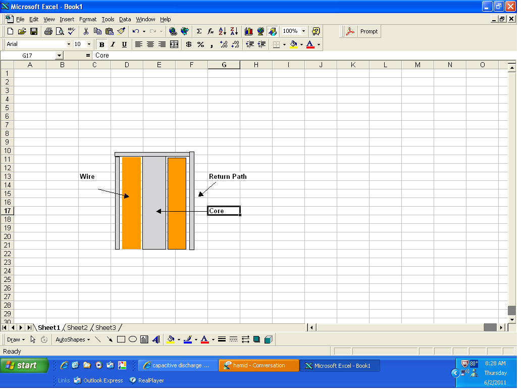

I think you coil is about 10 watts- so about .8 amps. The rule of thumb for the coil running continuous is about .5 watts per square inch of surface area. But I think we can do much more because it will only be on for 10 or 20% of the time. That is where I guessed at 48 watts or 4 amps at 12 volts. We can chose the wire size to get the desired current with the most turns.
Will your Chinese magnet come apart? I'm not sure what can be used for the return path, so it would be nice just to rewind your magnet with the bifilar winding and slightly larger wire. (see picture)

I will pick up a heatsink and other items on the way home. As for the electromagnet I already have.. It was only $20 bucks and it really isn't serving my needs, so I'm willing to see if we can get her apart. the one I have is only 49MM in dia. and roughly 1" tall (give or take a little). I get exact info on it and the other stuff i mentioned once I get home.
