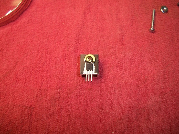

I picked up some things from the "Shack". I have to modify the heat sink they had. It is way larger than the MOSFET we are using. And I have to use a screw and washer to secure it to the heat sink
The Power supply I'm using is 13.8 V and 3 amps.. As listed on the label. I measured 14.0 V from my multimeter. I tried to take a amp reading and it was jumping all over the place, like from 9.1 down to .4.. Not sure what that was about.

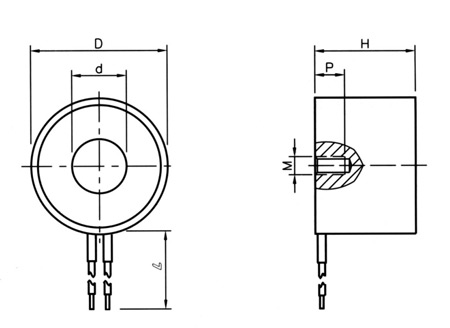

I also attached some of the info for the coil I need to build. The Chinese coil is 12v and .42 amps I don't think I can get it apart with out totally destroying it LOL

If that is how your Chinese coil is made, that is why you aren't getting the power you expected :) That is a solenoid coil, the main magnetic force is in the middle of the center tube. The magnetism on the outside of it is just incidental.
As an experiment take the largest hex head bolt that will fit through the Chinese coil and then apply your power to it. Then try and attract some thing iron to the head of the bolt. It should be much more magnetic than before the bolt was inserted.
You need what is called a "E" core coil. Basically a center core connected to a end cap and a outer sleeve connected to the same end cap. The inter core and outer sleeve should be slightly longer than the coil length and all of the added parts should be iron/steel.
Think of the magnet used in a scrap yard on the crane that moves the scrap.

That is not how the Chinese coil is made, what I posted was the start of my concept coil for our project.
The picture I posted is representative of some basic measurements I have to maintain to meet the constraints of the motor we are using in this project. I will be building a final coil that will include a metal shaft and plate matching the magnet dia. that is fixed to the top of the piston. That will be used to control the distance between the opposing magnets to vary the repelling force of the magnets.

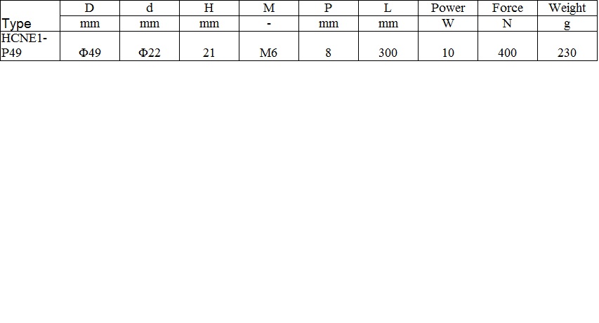

Here is the info on the Chinese coil I bought:
Electromagnet Solenoid
49mm OD, 21mm height
12VDC
Power:10W
Weight:250g
Holding/lift: 40kg
Type:HCNE1-P49/21

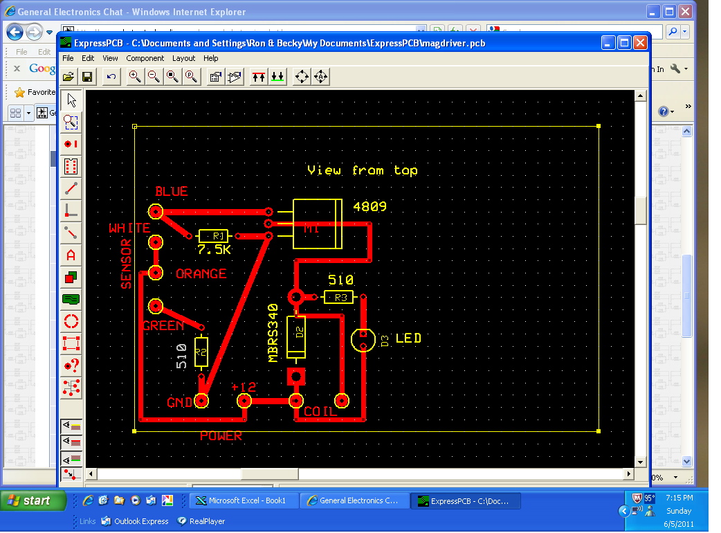

I like the idea of putting the magnet on the top of the piston. I think this would let us not worry about a return path for the electromagnet. I bet you can find some soft steel rod and just put a layer of tape around it, a couple of plastic washers pressed and glued to the ends. Then you can wind it and put the whole ting in some PVC pipe.
I'll work on a better picture of the parts hook up. You can test the circuit and sensor without the coil to start.
Coil circuit
Here is a better picture for the circuit board. The LED should light when the sensor sees the reflector.

RonV,
Thanks for the better circuit wiring layout. That helps alot!

Ron,
I'm laying out the circuit board and I have a few questions..
1) Is there a specific way the 7,5K resistor needs to go? The color bands are red, red, black, green, purple.. What I mean is, I know that some of those things have to go in a certain direction the current can flow right.
2) Same question for the two 510s, colors are purple, black, black, purple and green
3) Do I need heatsink paste (probably calling this the wrong thing) between the 4809 and the heat sink. I know you said I may not need it, but I had already set that up.
4) Is there a specific side of the circuit board that the components go on and a certain side that you should solder on.

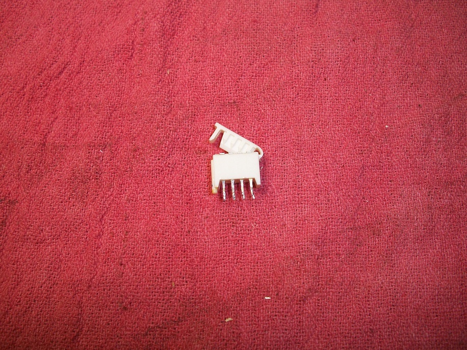

Here are some pictures of the four wire connector I pulled from an old piece of equipment that I want to use for the connections from the sensor. The other picture is of the heat sink I had already put together.

The resistors can go in either direction. I'm not sure what kind of board you got, but I usually put the components on the side wit no traces. Looks like you are almost there.:)
One side has like a little "L" shapes in a few places and it is shiny. The other side was dull and no markings.. I really didn't think it matters but then again I haven't built a circuit board from scratch before. My board is just plain jane, the kind with only holes set up in it.
Sounds like a regular pre-drilled board with no copper traces, so it doesn't matter which side you use.

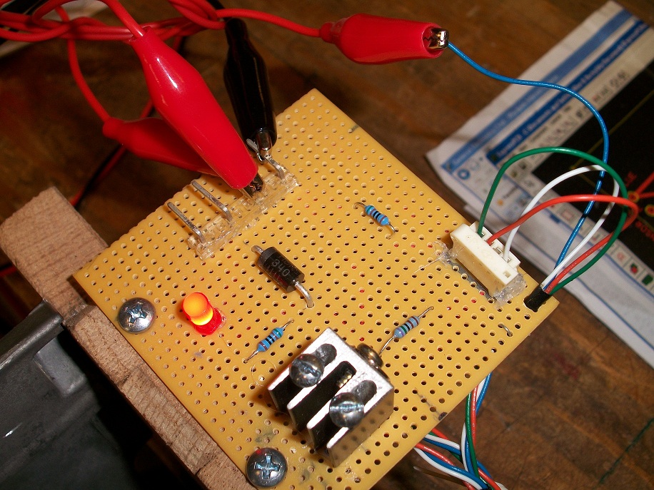

Circuit Parts are Mounted
RonV,
I got the circuit board put together this evening. From the wiring layout you did for me to wire the components together, I noticed that there are 4 leads for the sensor (blue, white, orange and green), white and orange are connected by a short jumper on the board. So i twisted them together and put them in the same location as indicated for the orange lead placement.
I thought I could just wire in the sensor as indicated, apply the (GND and +12) power connections from my power supply, connect the red and black leads from the multi meter then pass something reflective in front of the sensor and see a voltage reading at the meter.. No such luck.
So how do I test the circuit?
Kevin
Hi Kevin,
I think I would put everything together except leave the coil out to start with. Then when you place the reflective tape in front of the sensor the LED should light. But having said that the blue lead should go to +12 volts when the reflector is in front of the sensor. Where did you put the meter?

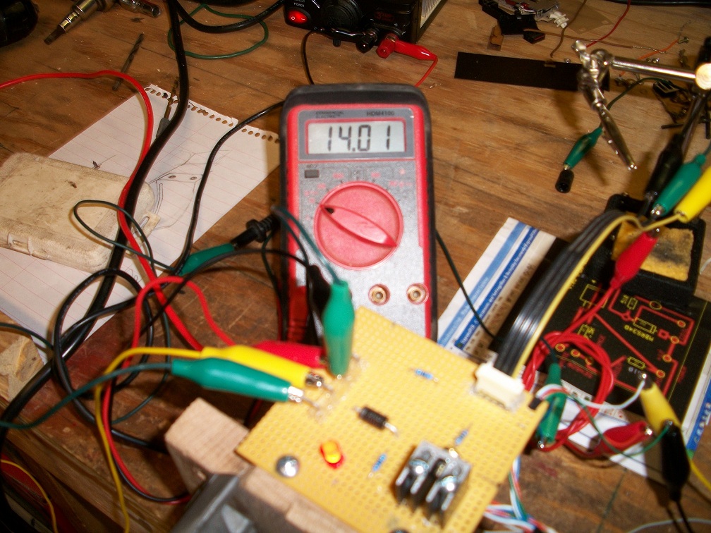

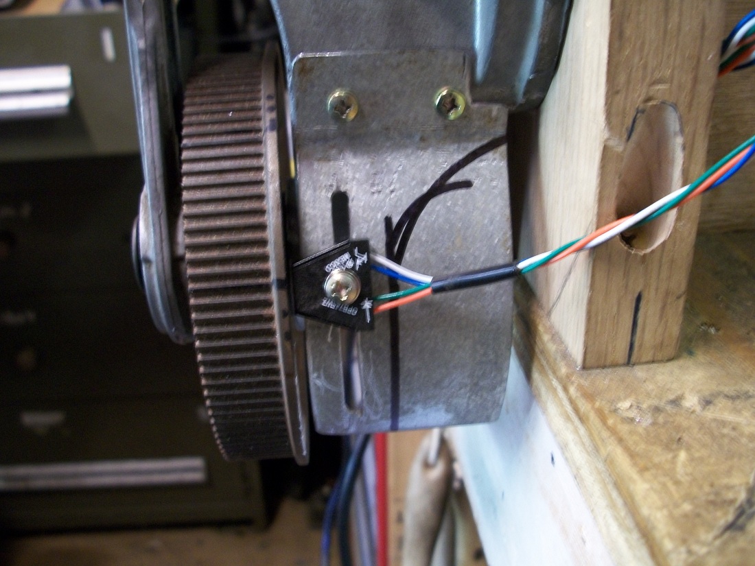

Today I made the bracket to mount the sensor, mounted the sensor and mounted the circuit board to the wooden stand in an effort to get all the parts centrally located.
I got the LED to light by connecting the blue wire straight to the 12v input lead on the board. Look at the picture for the wiring. The green and orange sensor wires are still in the original location but the white sensor wire had to go in the location that the blue wire use to be in. The LED stays on all the time though, meaning that the circuit is staying open I guess? I may have to check the circuit connection wires because I'm not getting 12V from the circuit board where it was suppose to be..
I did manage to get a reading on the meter from the "coil" pin locations (yellow and green wires) on the board (14.00 V reading on the meter) but I'm sure that was due to the circuit staying open.
No mater what combination of wiring I tried to do the only way I could get the LED to light was from the wiring connections i already mentioned.
I used a sharpy to blacken the back side of the flywheel then mounted the reflective aluminum tape on the flywheel and moved the flywheel to see if that might trip the sensor, but no luck. The picture isn't the best but you'll get the what I'm talking about.
I had to user stranded 16 gauge wire to do the circuit connections. I hope that isn't whats not making the circuit function correctly?

It looks like the blue and the white wires were reversed. Hope we didn't zap it.
So do I put the white wire on 12v now? And the blue back where it was? Nothing really came in the package that said how to connect it, I just went off the connections you laid out for me. Is there a way to test it to see if it is zapped?
