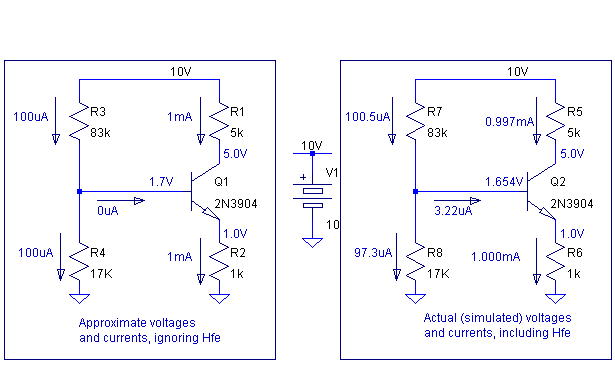

With the standard configuration, of a potential divider on the base, an emitter resistor and collector resistor, and keeping the gain to sensible levels! - you can ignore hfe as it makes less difference than the tolerances on the resistors. The gain of the stage becomes the collector resistor divided by the emitter resistor (negative feedback).
Perhaps an actual example would help show you how insignificant Hfe is for a stably biased transistor.
Referring 2 Ron's example, the potential divider is set 2 be at 8.3V. Why has it been set that way? If Vbb is at 1.7V, why taking that potential? And would it matter if we were 2 change R3 and R4 to say 41.5K and 8.5K (keeping ratio same)?

The base voltage is set to give the correct collector and emitter voltages, usually to allow for maximum swing on the collector.
Reducing the values of R3 and R4 won't affect the circuit much, only decreasing the input impedance, and increasing the current consumption.
The potential divider should have a MINIMUM of 5 times the base current flowing through it, increasing that to 10 times is slightly better - with the disadvantages mentioned above.
BTW Ron, thanks for the diagrams and calculations, a fine example of what I was saying.

Hey, please help.How i see it is this:
PD across emitter and gnd is 1V. Considering voltage drop across b-e junction, the potential at base is 1.7V. So shouldn't the potential divider be set to divide the potential at 1.7V? I observe its been set such that Vbb+(PD across base and potential divider node)=Vcc
ie 1.7+8.3=10
Why is it so?
ie 1.7+8.3=10
Why is it so?
Apakhira, you're scaring me. The base divider is set at 1.7V:
10V*17k/(83k+17k)=1.7V.
The emitter voltage is 1V because it is 0.7V below the base voltage.
Maybe I just don't understand what you mean.
OK. I'm extremely sorry 4 asking this stupid question. I had made a blunder by calculating Vbb = 10V*83k/(17K+83k)=8.3V
God! I'm scaring myself! How I could i have thought that, when R4<R3? I wonder
why i 4get the basics sometimes while thinking on these things.
