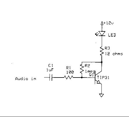

Hi, I'm trying to make a luxeon LED 'pulse' to music. Could anyone recomend me a transistor...

700ma @ 3.9v

You could use a TIP32 PNP but your audio would have to be at +12 volts. A better circuit is below, using an NPN transistor:

cocoadev said:
thanks Russlk, I cant work out the value of R2 there? what would it be?
It's labelled 1MOhm - bad choice of graphic format though, using the JPG format loses quality and makes the file considerably larger. For diagrams you should use GIF, 100% quality, and smaller files - save JPG's for photo's where it's compression works, and the losses don't matter.
